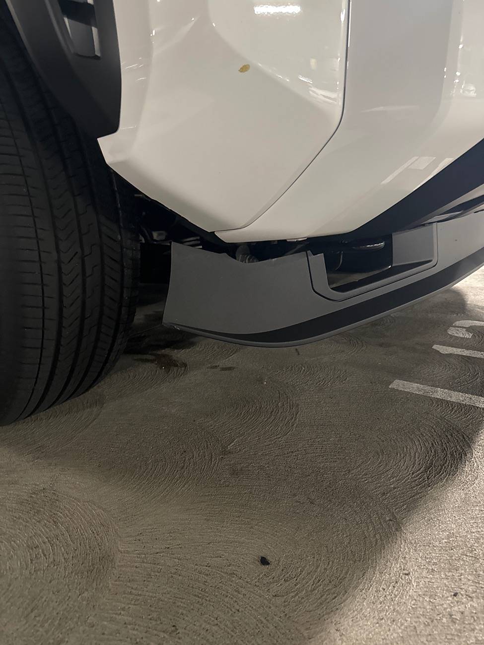

89 miles on odometer, 5th day owning, first time on highway and air dam ripped/ fell off at highway speeds

Any evidence that screws were missed, came loose or??
I checked mine tonight and found all tight except for one slightly loose. I retightened.
I checked mine tonight and found all but one slightly loose.
Unsure :((( , drove it off the lot 5 days ago and it has been parked in the structure for 3 days without moving while I was at work and drove it today

The edges are jagged, it looks like it was ripped off. You may have hit something on the highway and tore it off from the screws that hold it on.
I don’t think I hit anything, could be a chance but both my passengers confirmed the theory nothing was hit.
The tires most likely ripped it off after the snag, moderate fray damage to inner tires; it was flopping for about 30 seconds making a clicking sounds that got louder and then heard the rip from the passenger side confirmed by my passenger. and then we heard clicking from driver side then same rip that I can hear passing through my back tires, center portions still intact

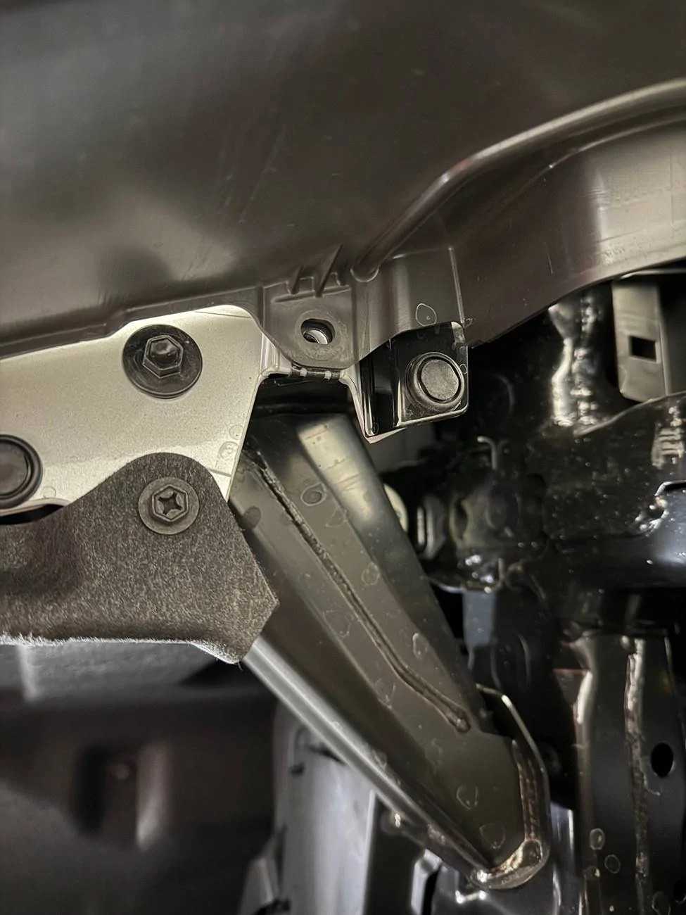

I just checked ours (TRD Sport Premium, ~150 miles) and sure enough, one of the screws on the passenger side is missing. All others are at least finger tight. Did not hit any curbs or debris. I’ll be reporting to our local dealer tomorrow.
