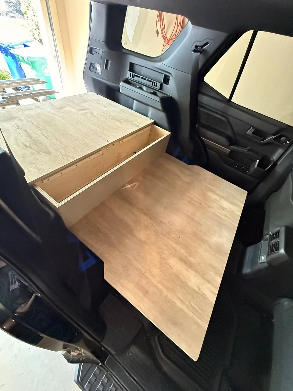

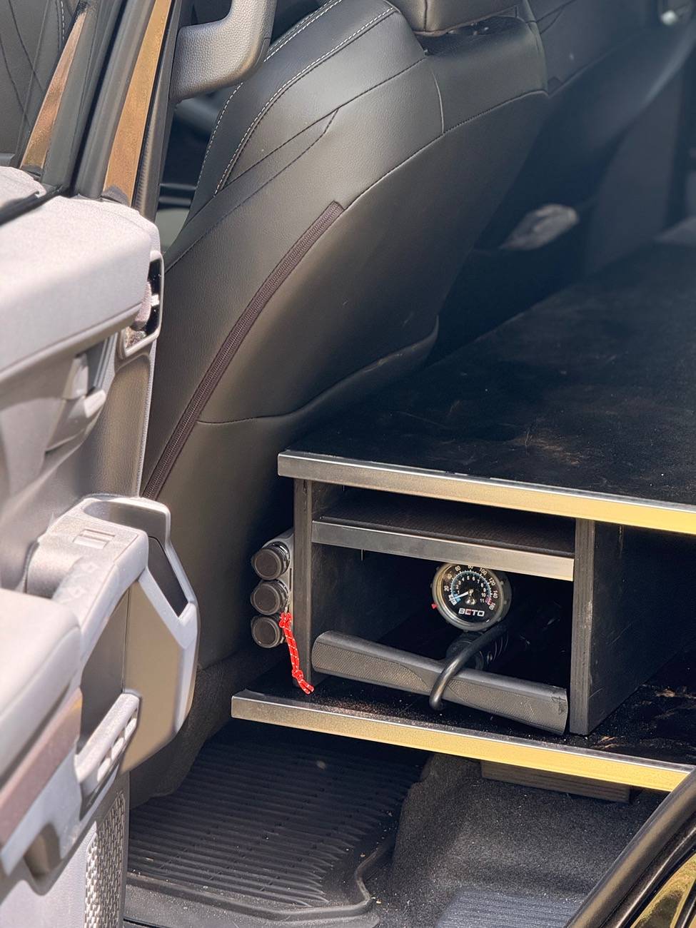

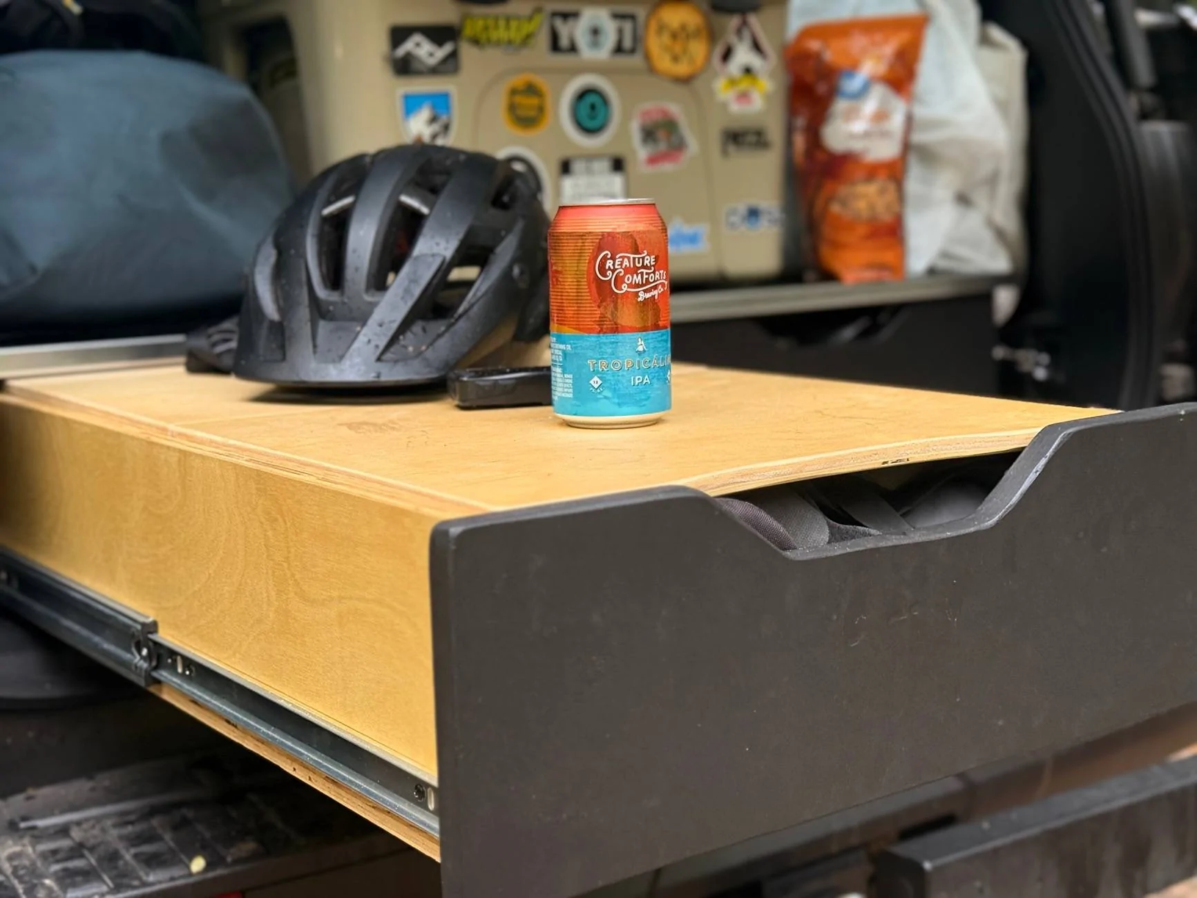

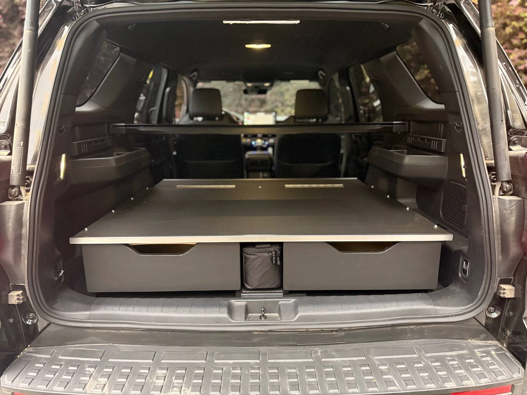

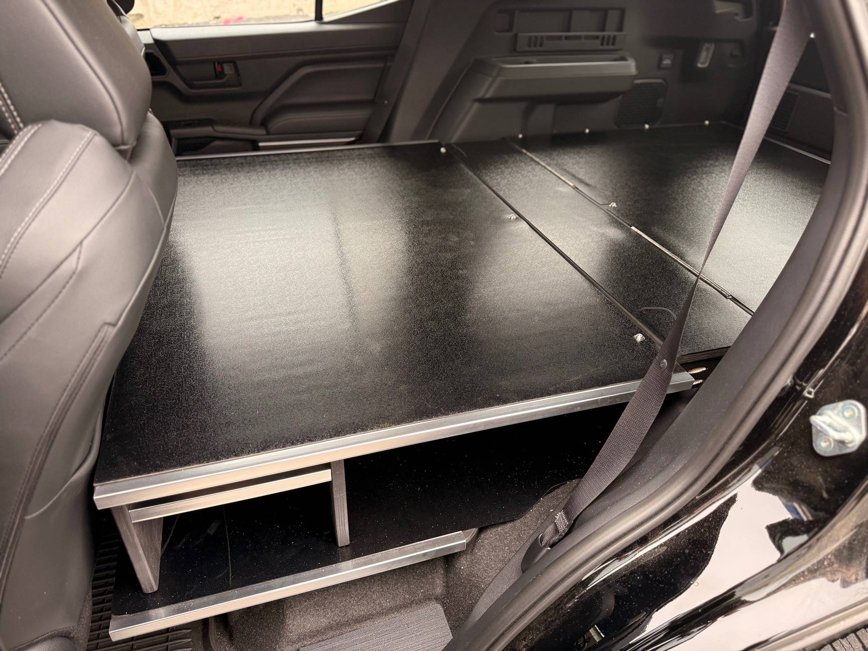

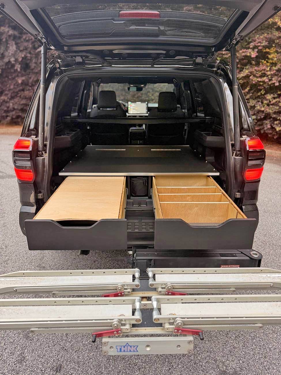

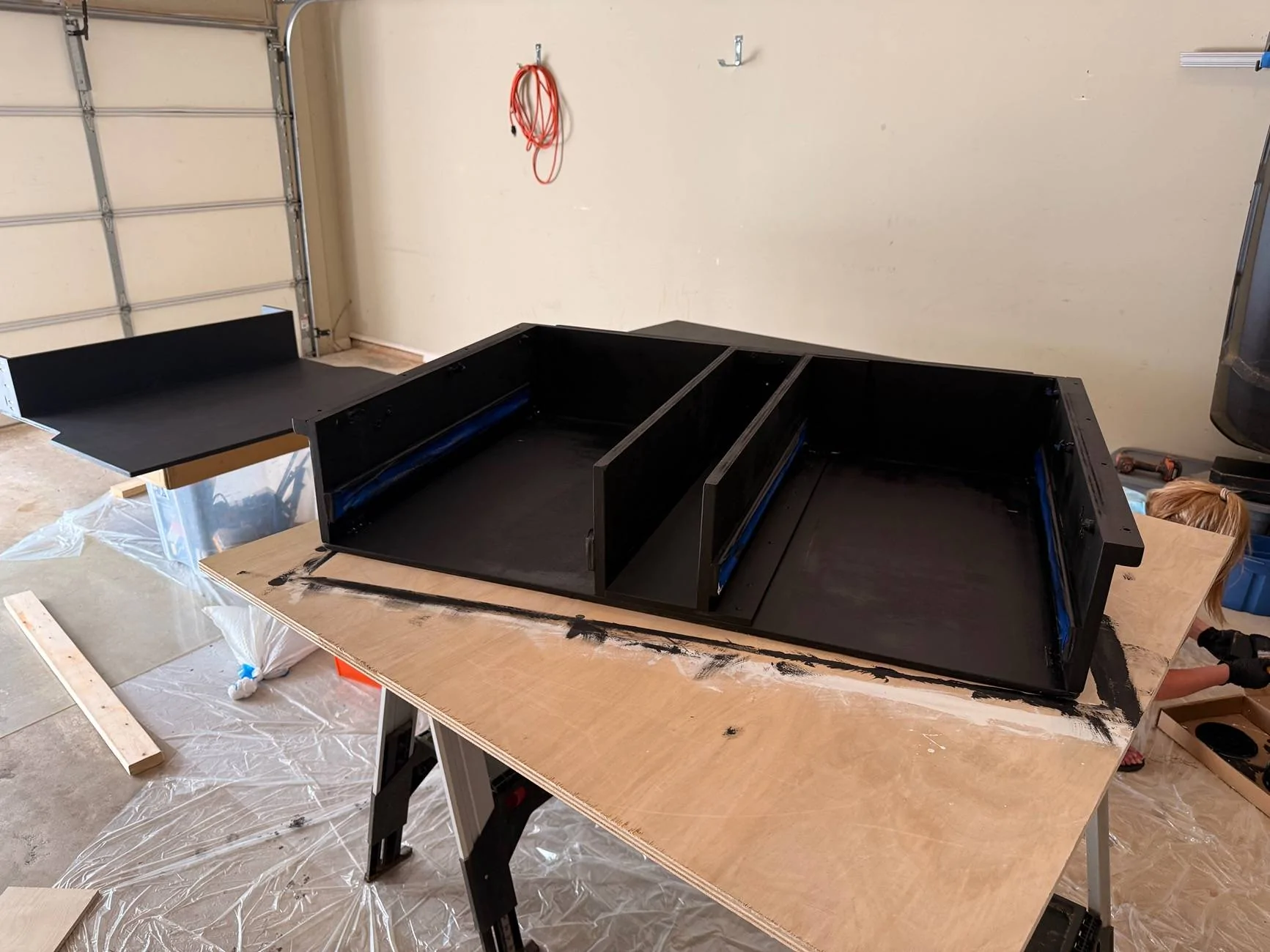

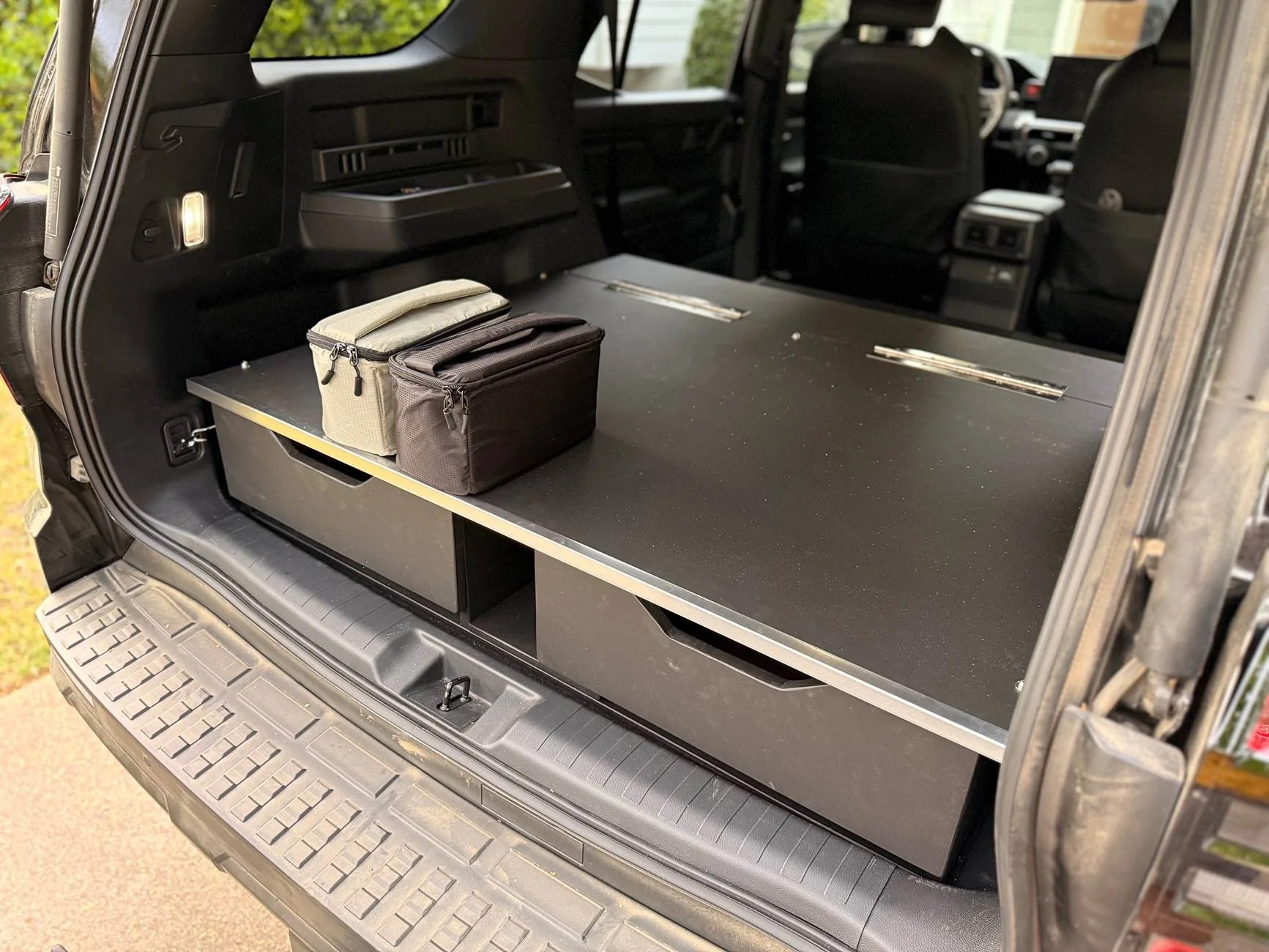

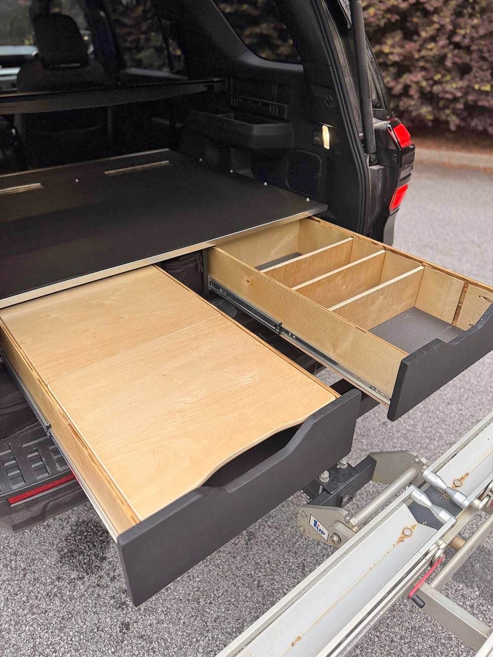

I removed the rear seats and started building a platform with extra storage and drawers. This is a non-hybrid ORP. My wife and I are mountain bikers always on the go somewhere to camp and ride. We wanted some more storage and less wasted space, so the rear seats had to go. If only Toyota had them fold flat…

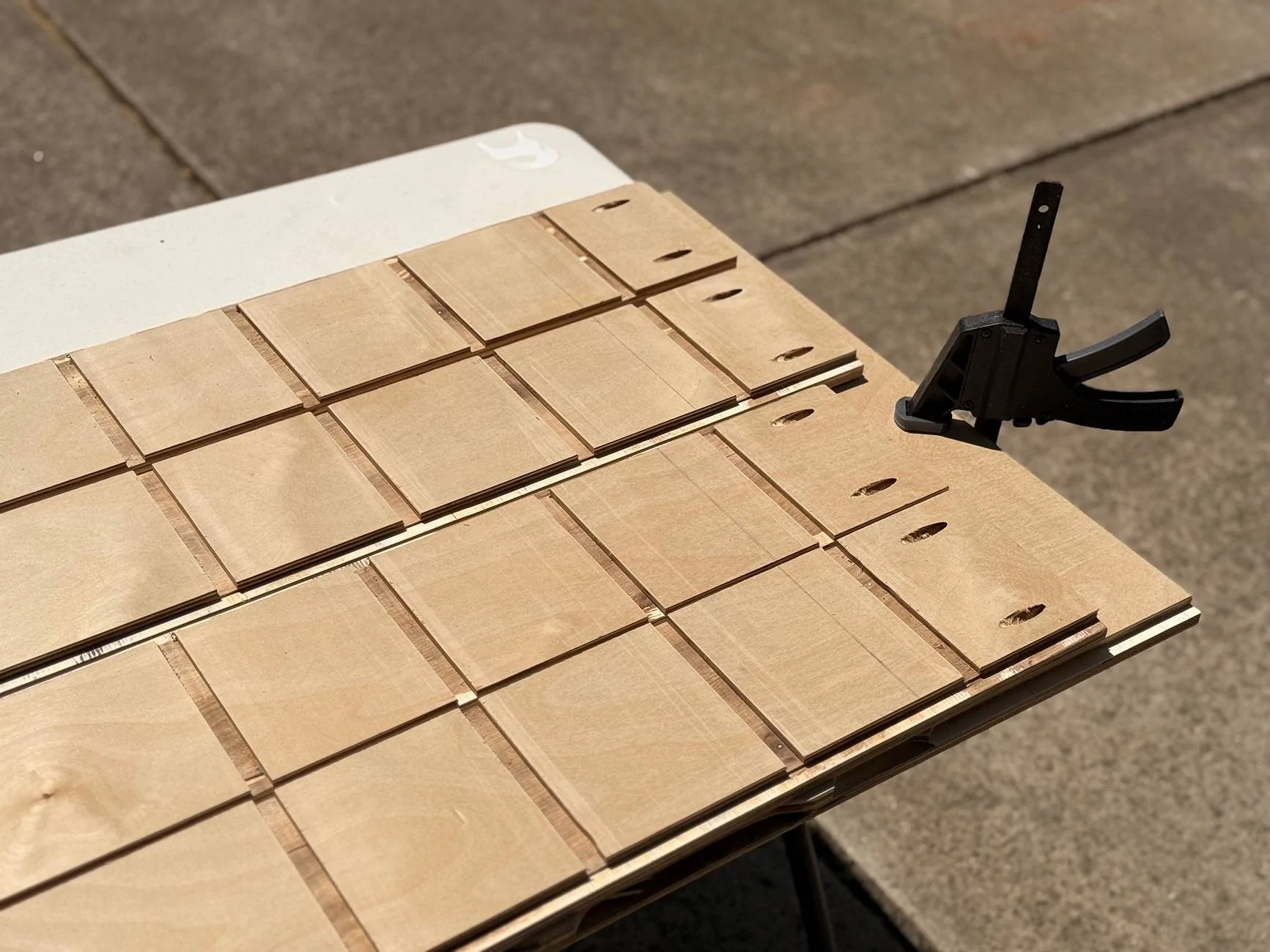

I’ve never used a router or made pocket holes before this project— it’s been an enjoyable learning process in my spare time.

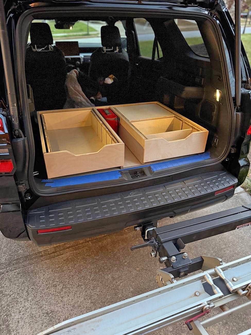

The entire drawer system is designed around the power lift gate access panel inside the truck. In the event that the power latch were to fail, you’d need to access the little panel on the back hatch from the inside. A drawer system complicates this, so I designed a 5.5” channel between the two slide out drawers. Additionally, the entire top surface above the drawer system can be removed with 1/4-20 bolts from the inside of the vehicle. I used threaded inserts in the wood to achieve this so it can be removed and reinstalled multiple times without any issues. This is also a requirement of my design to access the bolts mounting the box to the frame.
Luckily, that little storage channel can fit 2 small bags filled with tools plus a sixer. It works out well.
There’s a wide storage area with a hinged lid that is held close with a strong magnet. I went a bit overkill on the hinge as I have some future design plans that require extra strength. I had some issues finding a quality piano hinge that spanned the full width, so I just went with what I had available.
For now, the factory cargo cover is installed to prevent bags from sliding forward. I’ll eventually build a stronger wall/divider so a dog could safely ride where the rear seats were located.
The rear seat area is now a large, flat surface for our storage needs. Our Yeti cooler fits on one side. It was designed with a custom memory foam dog bed in mind. We recently said good bye to our 17 year old Siberian Husky who had a custom dog bed in our 5th gen after I deleted the seats from that truck. She loved all the space. Another dog will be in our future, but not yet.
Up next— a foldable platform that can be positioned on the rear seat platform for a flat sleeping surface.

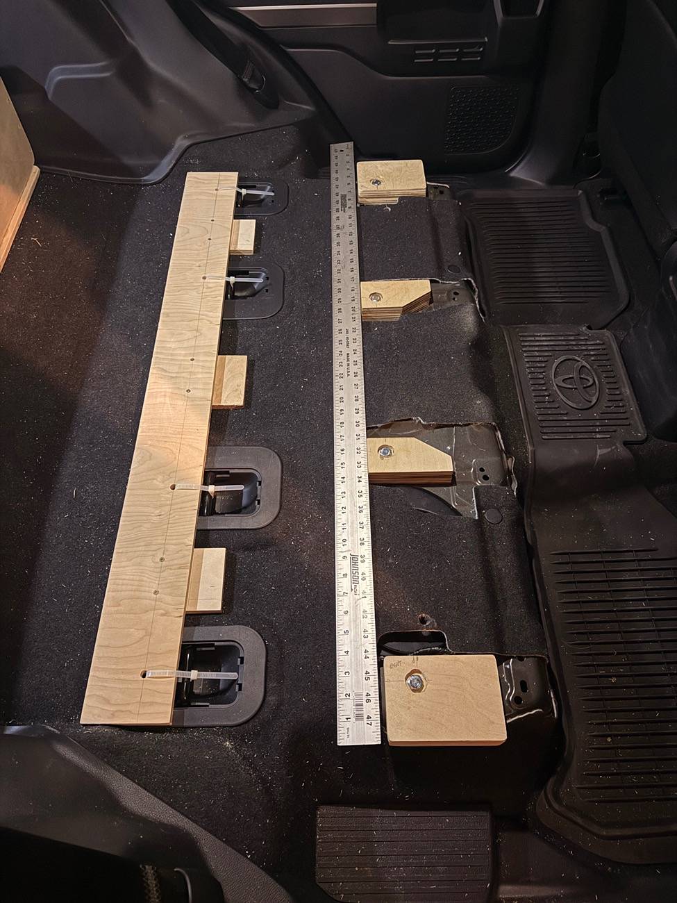

Toyota made things tricky with the 6G. Nothing is flat even after the seats are removed. Connection points on the frame are super limited and/or at weird variable depths. For example, I removed the metal clamps on the floor that the seats latch to. You'd assume they're all bolted onto a flat surface, but no. There's also less than ideal cargo attachments in the rear for the turnbuckle to bolt into. The 6G cargo holds are flip out, so they don't keep position well and not on ground level near the very back of the truck.
Also, the rear lip is 1.75" tall, so for a drawer system you have to waste space by raising them above this.
Building something like this in the 5th gen is far easier.

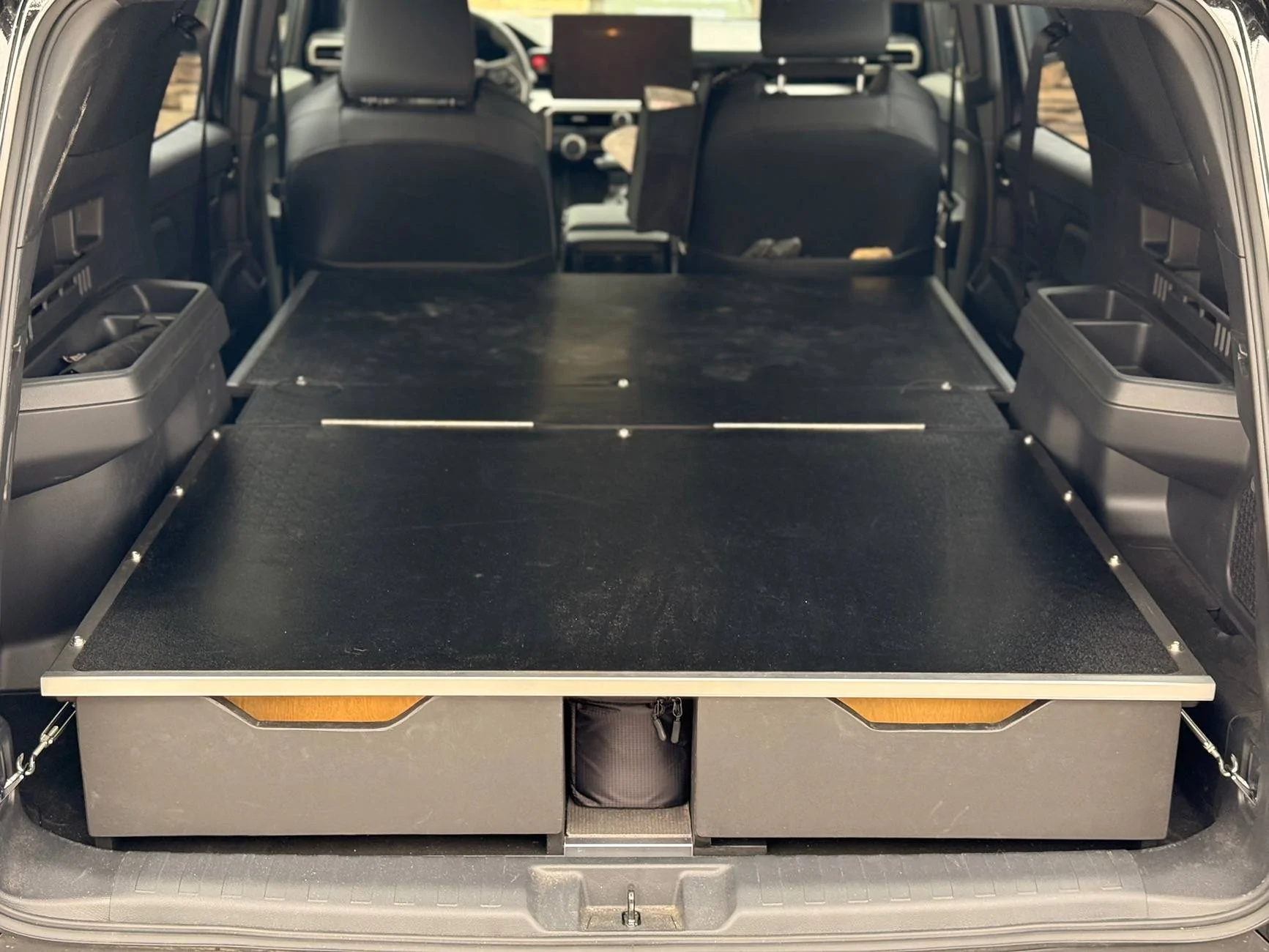

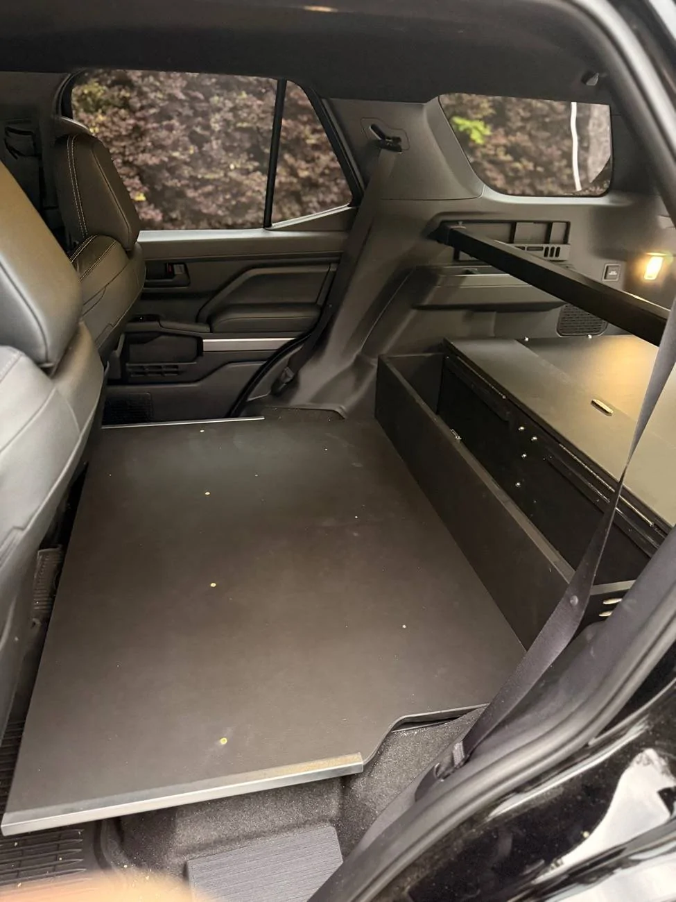

Thanks! I’ll post some updated photos soon. I’ve modified it so the entire floor is now level with storage compartments below— accessible from the rear seat doors. Stores bike pump, two folding tables, etc.

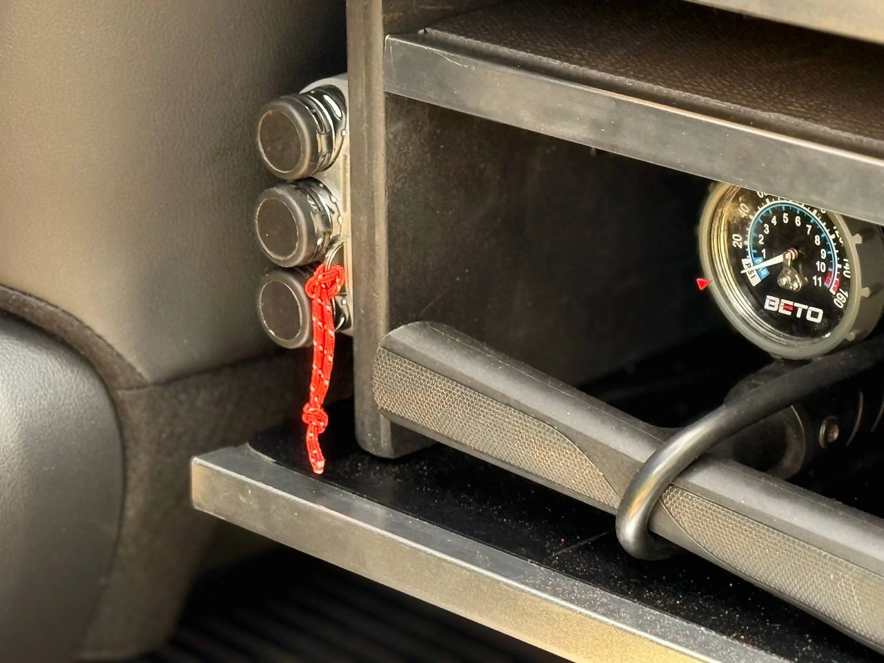

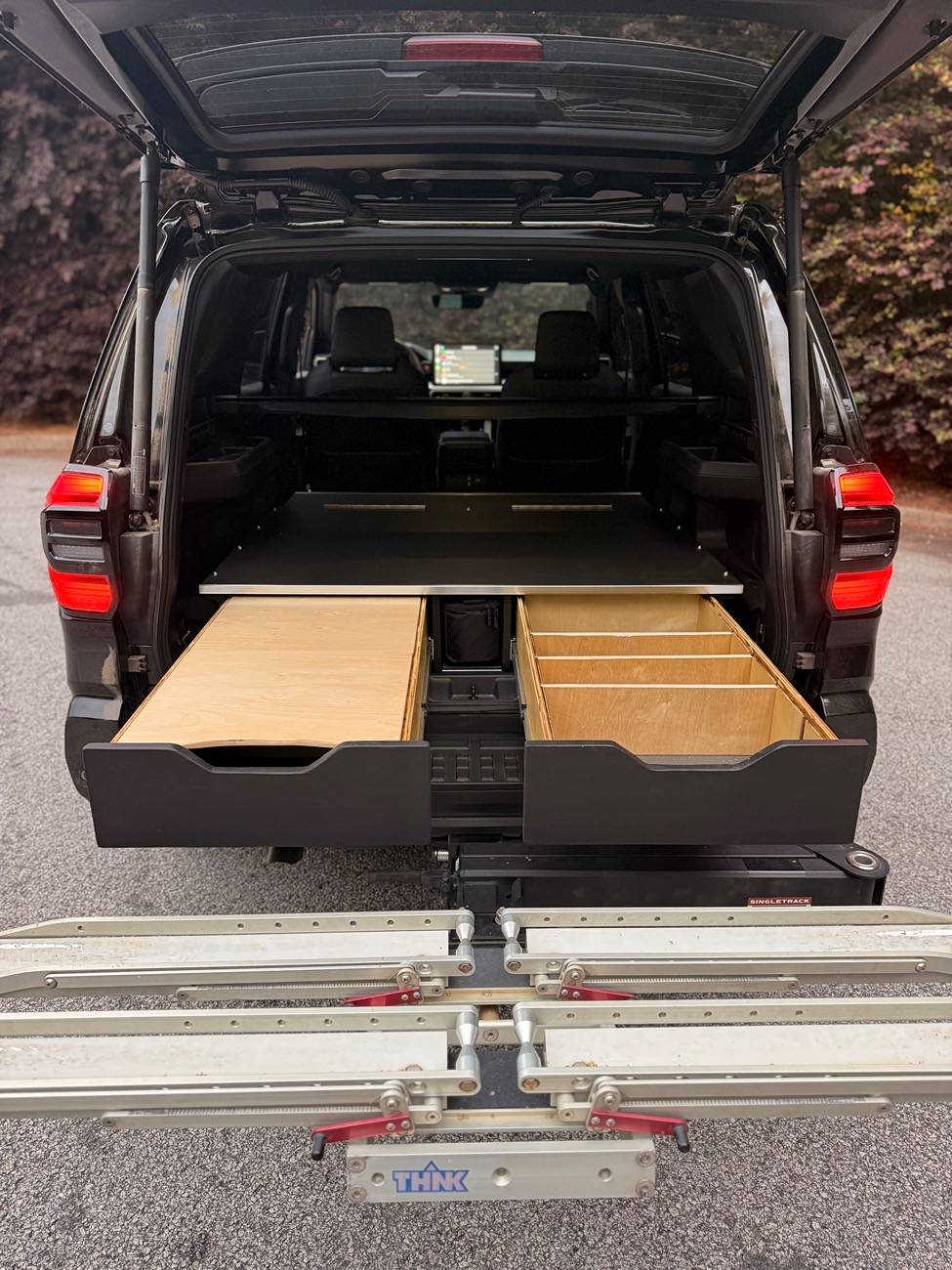

Here’s the latest. A bit dirty inside after cutting the mats, but ready for use. Bike pump fits in the first compartment with trekking poles in the narrow shelf above. Extra room to store other items next to that area. On the others side there’s storage for camping pads, two folding tables and a stove under the main platform.

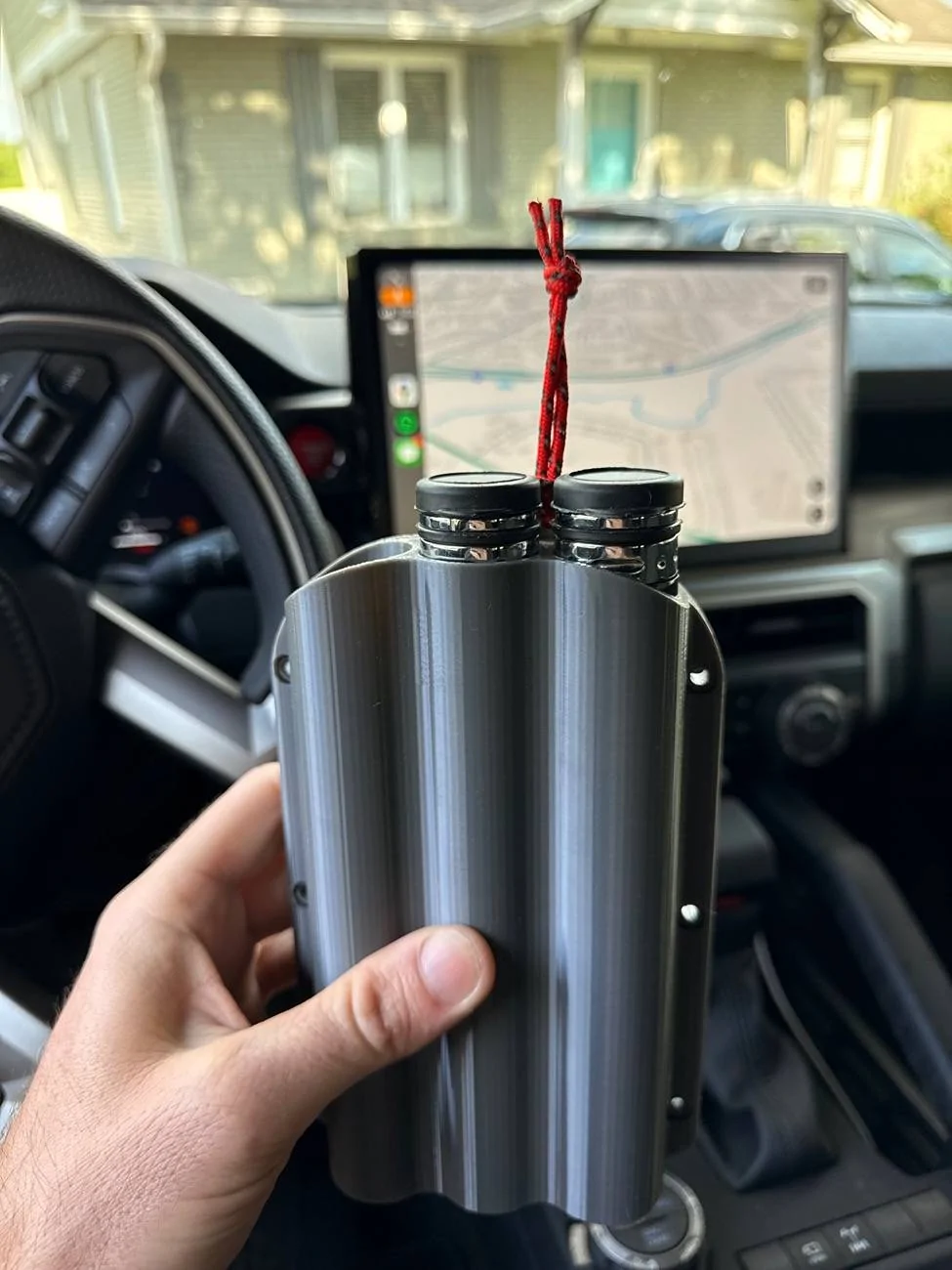

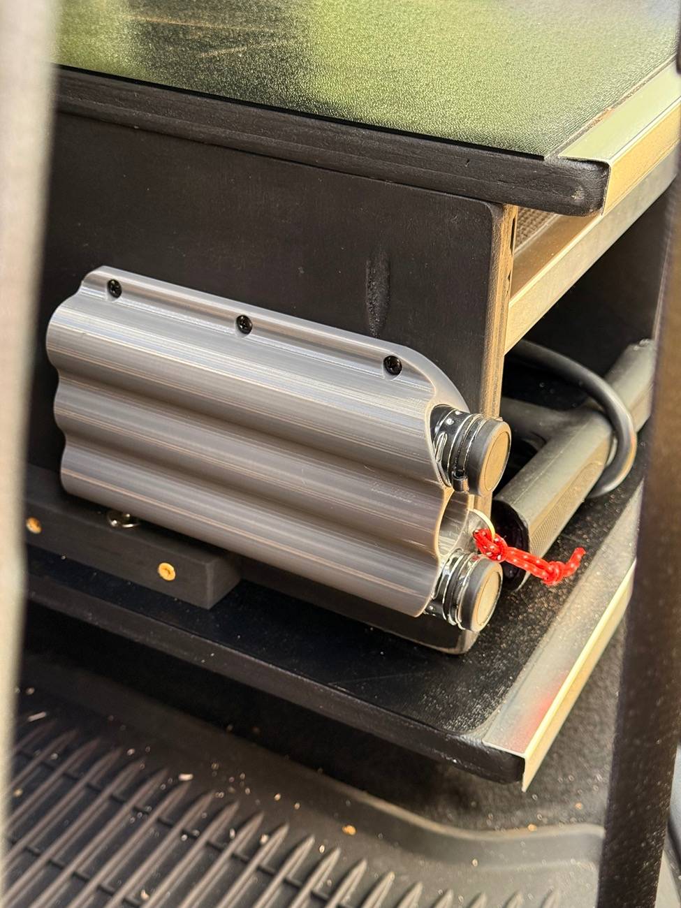

The latest addition is a custom 1up lock and key holder I designed and 3d printed.
