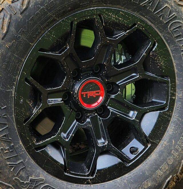

Does anyone know the offset specs of the wheels that come on the TRD Pro? I’ve seen quite a few 6G T4Rs with 35s but they all seem to be running aftermarket wheels. Jeff Westcott ran Method wheels with a +35 offset on the white TRD Off Road on his YouTube channel.
I really like the TRD Pro wheels and would like to know what their offset is/whether they’ll work with 35” tires. 🛞 🤙🏼

The offset for the TRD Pro wheels is +20 Offset. I think it might be just a bit too much for the trims other than the TRD Pro and Trailhunter. Reason I say that, is the fenders and bumpers are different on those 2 models. They also have wider fender flares. Jeff W said he will have a TRD Pro in the shop in the next couple weeks for test fitting so I am standing by to see what he says. I have a TRD Pro allocated for the end of the month so I am itching to find out

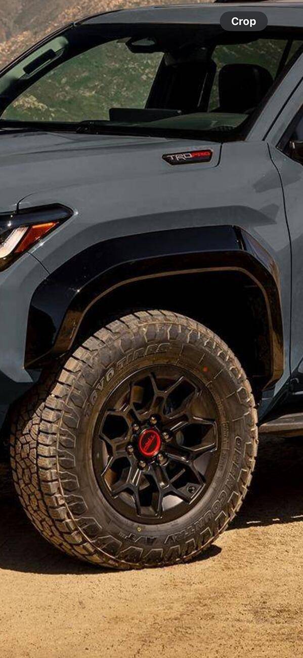

I replied to your post in the other thread:
Here's specs for the TRD Pro Wheels:
TRD PRO Flat Black 18" Wheel - Toyota (PT946-35240-2F)
PART NUMBER:
PT946-35240-2F
PRICE:
$285 MSRP ($223 online)
COLOR:
Flat Black
DIAMETER:
18"
FINISH:
FLAT BLACK
OFFSET:
+20 mm
Wheel Hub Diameter:
Ø95
WHEEL NAME:
WHEEL WIDTH:
8.5"

Thank you!! Those are the best pics I’ve seen of the TRD Pro wheels. I really like them.
