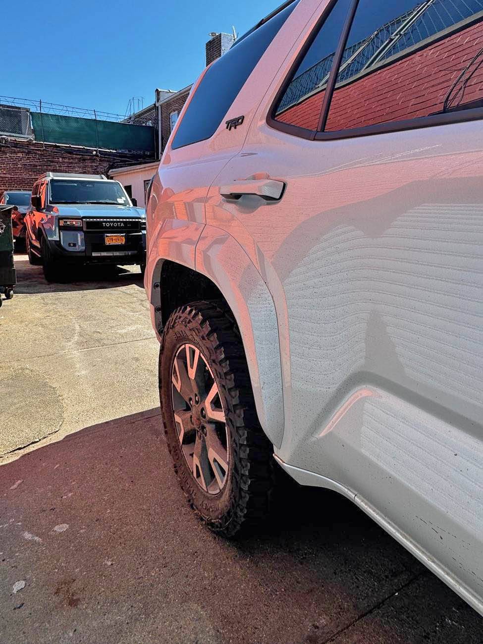

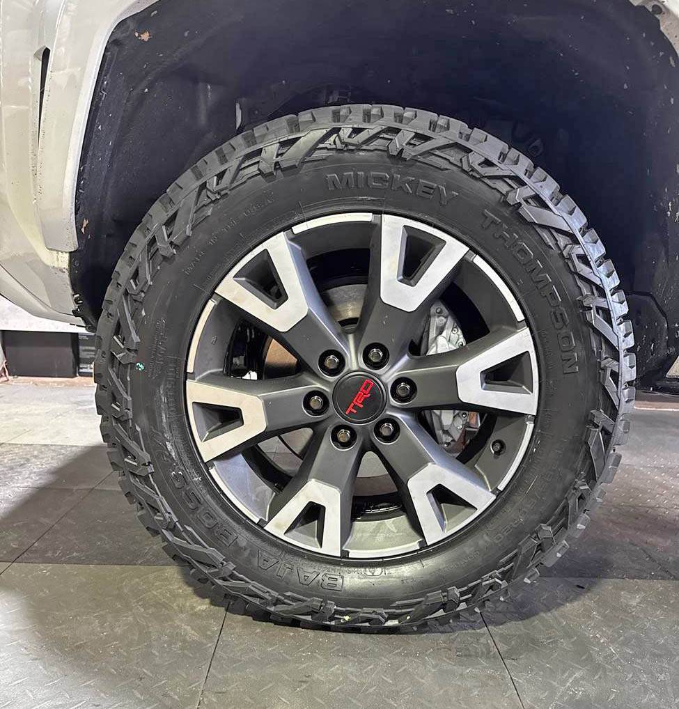

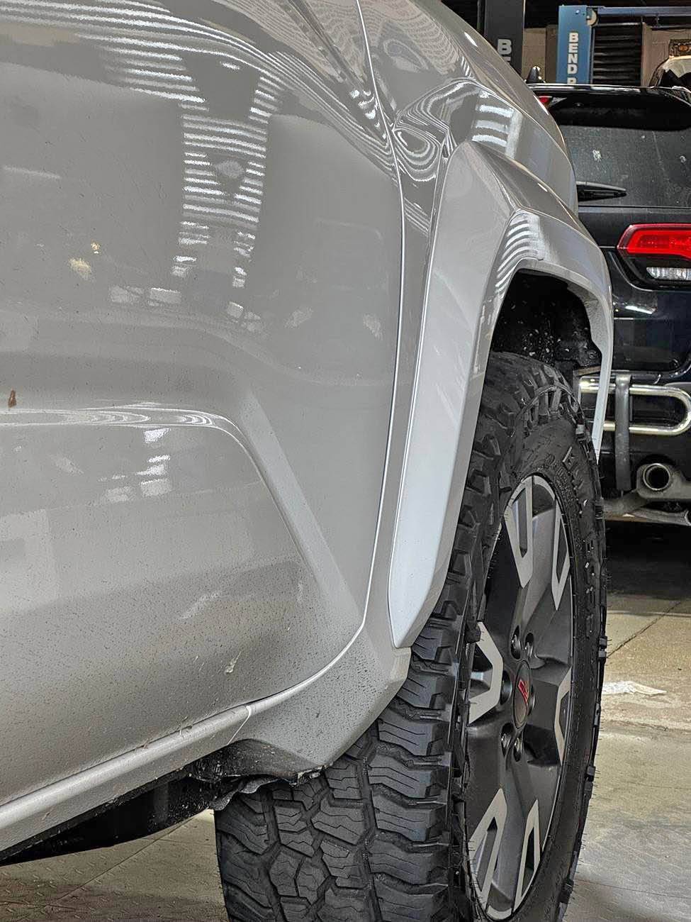

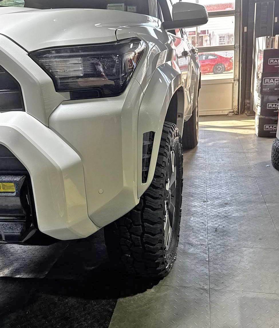

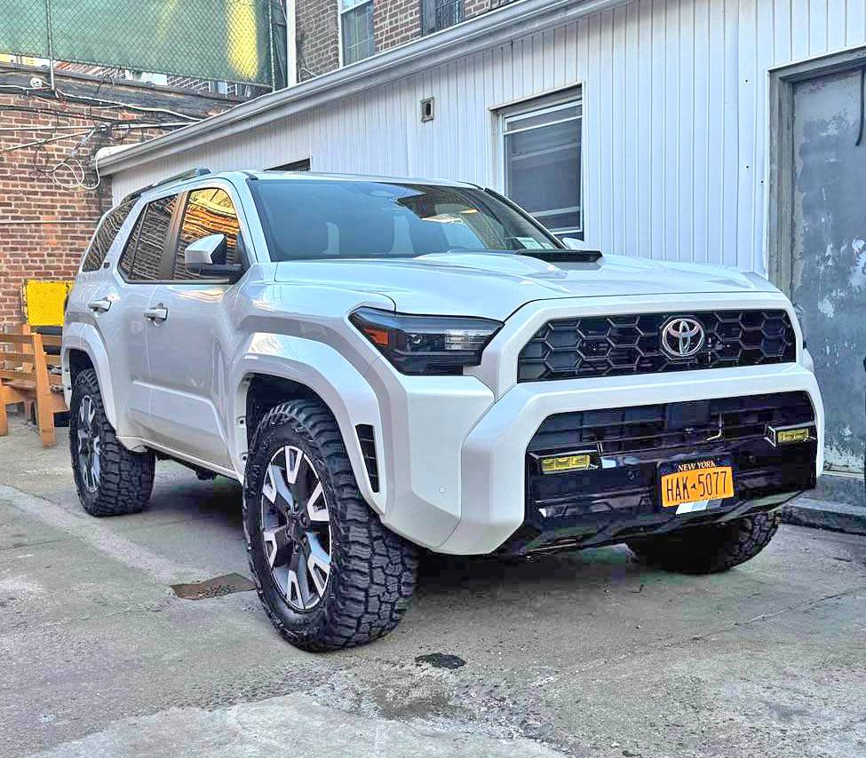

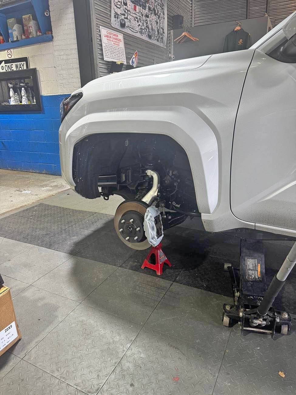

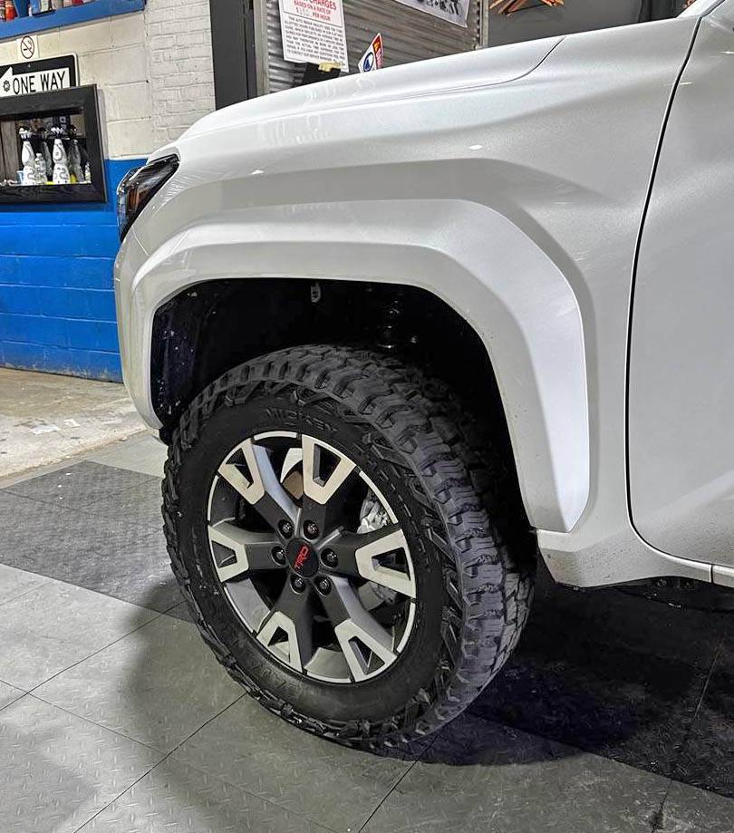

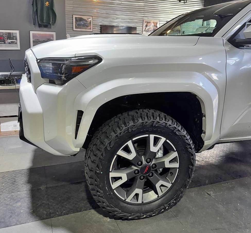

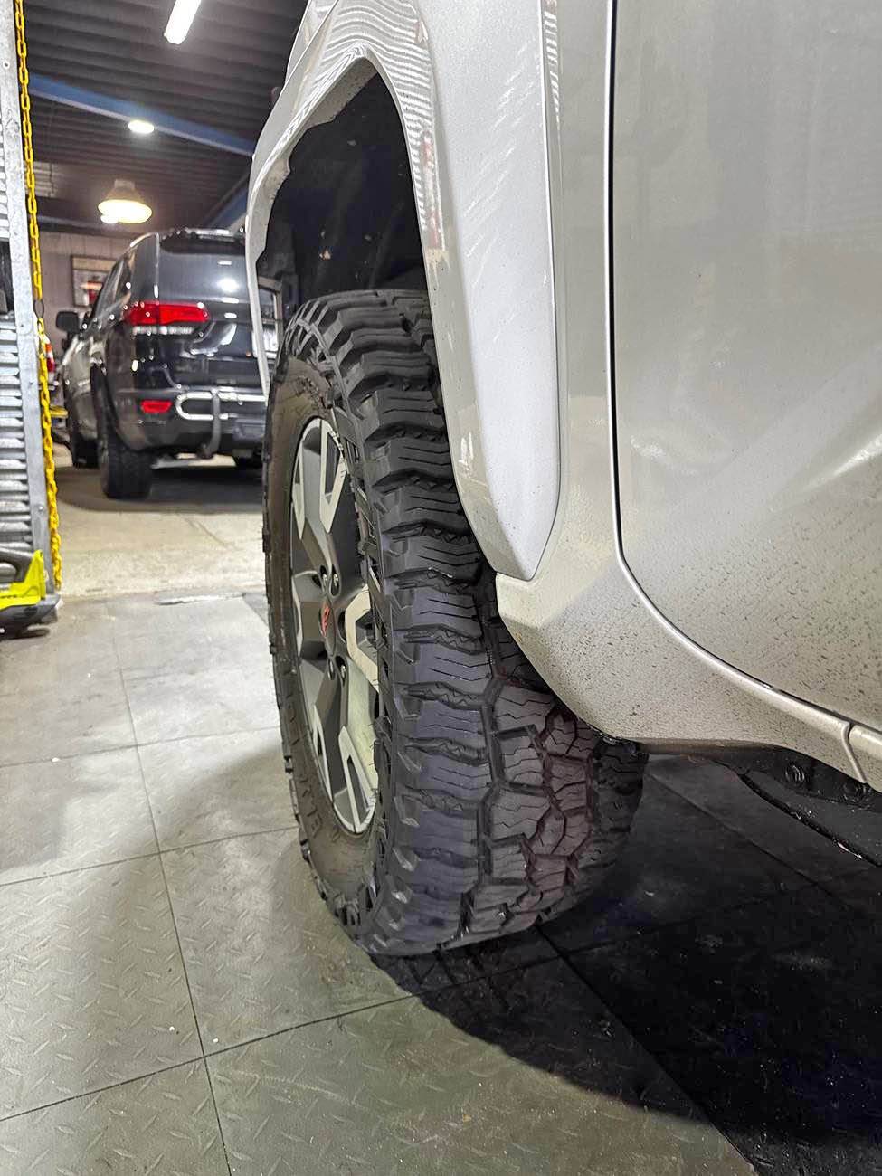

Put some beefy 285/60R20 Mickey Thompson Baja Boss tires on the rig. I believe it’s a hair over 33s.
No rubbing at all.
2025 4runner 6th gen Bigger tires 33's 285/60r20 on my TRD Sport factory wheels (Mickey Thompson Baja Boss) 285:60r20 tires 2025 4runner TRD Sport factory wheels2
2025 4runner 6th gen Bigger tires 33's 285/60r20 on my TRD Sport factory wheels (Mickey Thompson Baja Boss) 285:60r20 tires 2025 4runner TRD Sport factory wheels9
2025 4runner 6th gen Bigger tires 33's 285/60r20 on my TRD Sport factory wheels (Mickey Thompson Baja Boss) 285:60r20 tires 2025 4runner TRD Sport factory wheels8
2025 4runner 6th gen Bigger tires 33's 285/60r20 on my TRD Sport factory wheels (Mickey Thompson Baja Boss) 285:60r20 tires 2025 4runner TRD Sport factory wheels6
2025 4runner 6th gen Bigger tires 33's 285/60r20 on my TRD Sport factory wheels (Mickey Thompson Baja Boss) 285:60r20 tires 2025 4runner TRD Sport factory wheels5
2025 4runner 6th gen Bigger tires 33's 285/60r20 on my TRD Sport factory wheels (Mickey Thompson Baja Boss) 285:60r20 tires 2025 4runner TRD Sport factory wheels4
2025 4runner 6th gen Bigger tires 33's 285/60r20 on my TRD Sport factory wheels (Mickey Thompson Baja Boss) 285:60r20 tires 2025 4runner TRD Sport factory wheels3
2025 4runner 6th gen Bigger tires 33's 285/60r20 on my TRD Sport factory wheels (Mickey Thompson Baja Boss) 285:60r20 tires 2025 4runner TRD Sport factory wheels1
Update:
Just went in a trail called two towers loop in nj. No issues at all. Will definitely put westcott level kit in the future

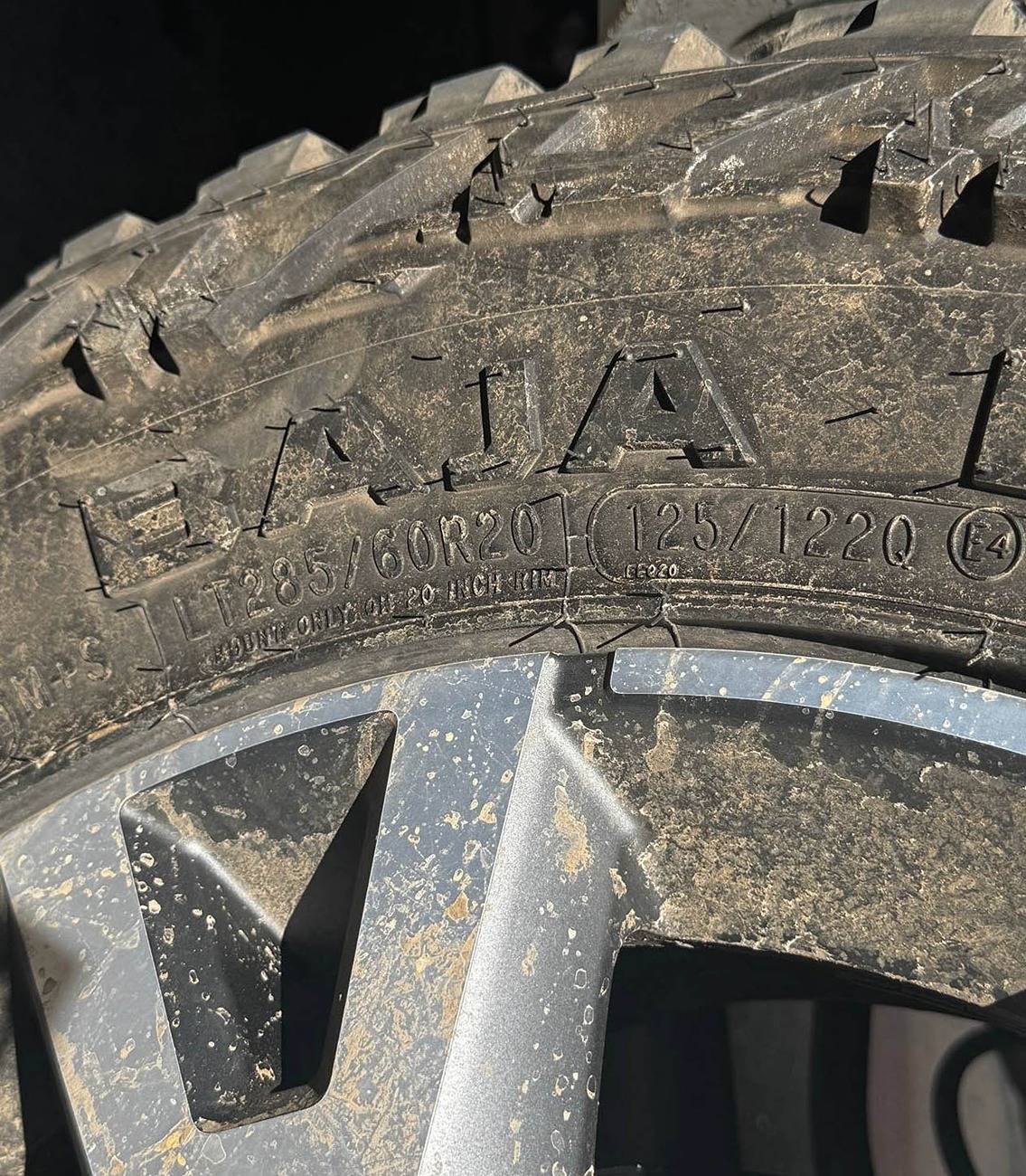

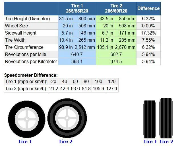

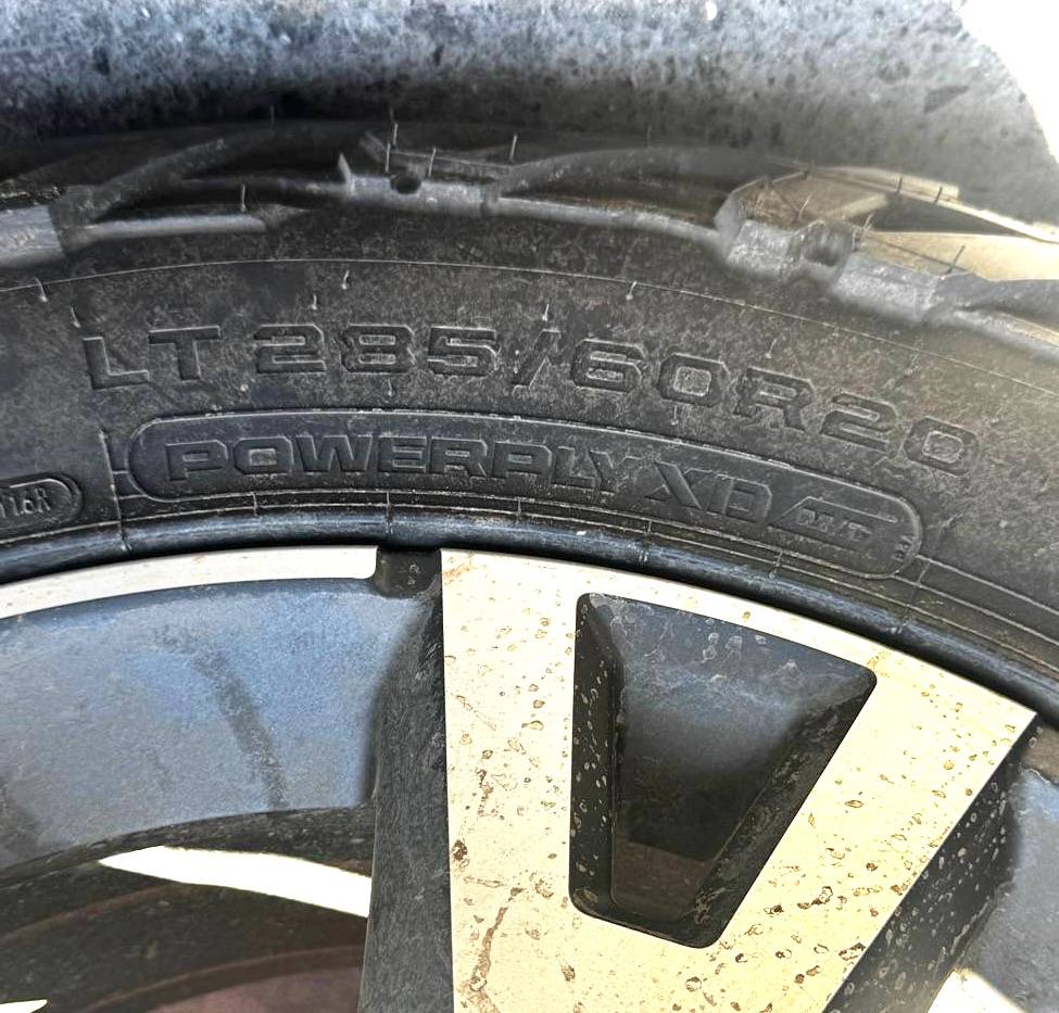

@samuelvelas congrats! That's a question I have been having as the stock 265/55R20 tires are a weird dimension with not much choice out there.
Can you confirm the size you put? I zoomed and think I could read 285/60R20. That would make those new tires 33".
How is the handling with them and do you have any rubbing when turning the front wheels to the max?

285-60r20
no rubbing at all. Just went in a trail called two towers loop in nj. No issues at all. Will definitely put westcott level kit in the future

very nice! I’m trying to keep the stock 20” wheels as well, but I’m getting the readylift 2.5” lift and they say the biggest that will fit with that is 285/65/20 which is like an inch taller than yours, so do you think the 285/65s will be big enough for the 2.5? I want the proportions to look right but the max size of 285/65 came from readylift so I guess I shouldn’t try to go any bigger than that

You can always trim a hair off the fender ok the inside. If you want to go large you deffinetly can just may need minor trimming in the inside fender

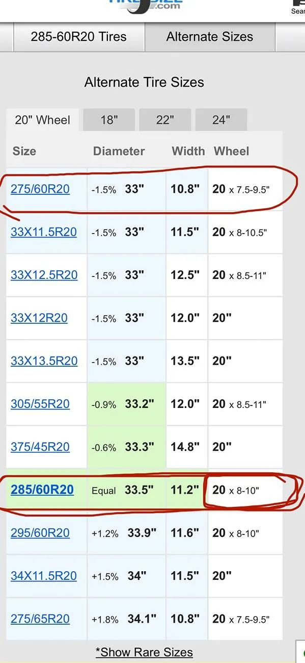

These tires need a minimum of a 8” wide rims that why I didn’t pick them over the 275/60/20 that needed a minimum of 7.5”
But the stock 20s are 8” wide
