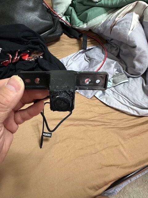

tigerchun
Chun
May 19, 2025
Charlotte
2025 4runner xp
Maybe too soon, but I would like to add a front camera that works with the display to my 2025 SR 5 any ideas ? There is a fake camera already there. Also I am sure there will be parking sensors available at some point after market or though Toyota parts

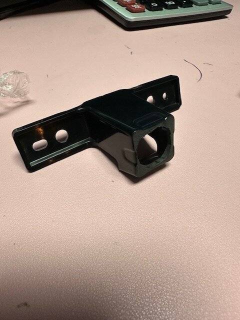

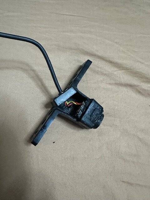

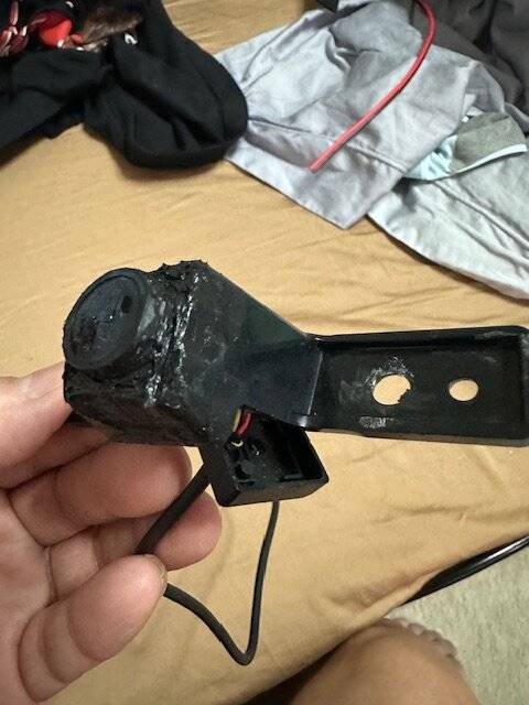

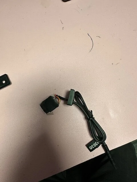

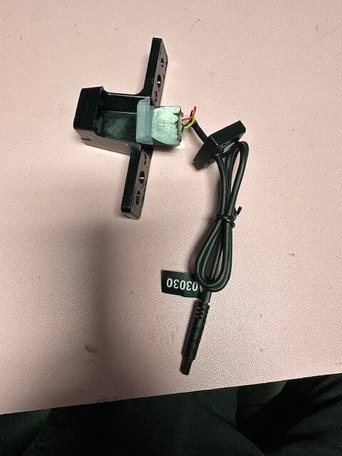

I fit all out and it work on the @Wolfbox 950 pro tri

toyoda80
Beau
May 12, 2025
54
2025 4Runner SR5 4WD Cutting Edge
nice! is that mounting bracket behind the bumper? did everything seal up tight? got any video or updated pics of final install? this looks like a useful project! Thanks!

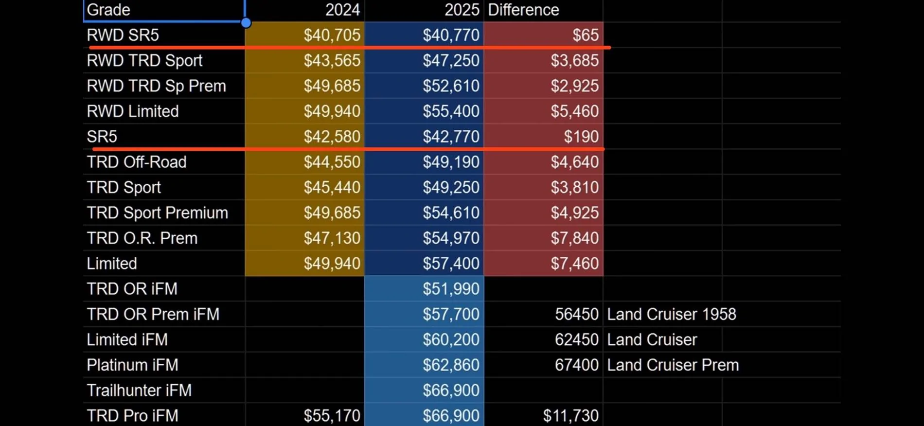

This! All the other trims shot up in price, but the SR5 kinda remained the same-ish. Here is a screen grab from Kirk Kreifels’ review:
