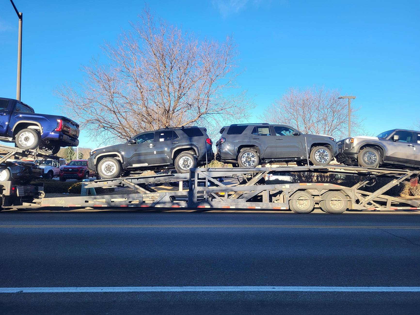

My ORP came with 265/70/R18, which is only a 1.1" increase in tire diameter (0.55" increase in distance from axel center to ground) over your current tires. Mine are ~32.6". The tires you are looking at, 265/65/R20 should be ~33.6", ~1" in diameter increase over my tires, but ~2.1" in diameter increase over your current ~31.5" tires. The suspension is a little different between our trim levels, but I doubt it's much different and I'm guessing I'd be ok with a 1" diameter (0.5" radius) increase. They're all 265mm wide. Here's my ORP on the delivery truck next to a Sport for reference...

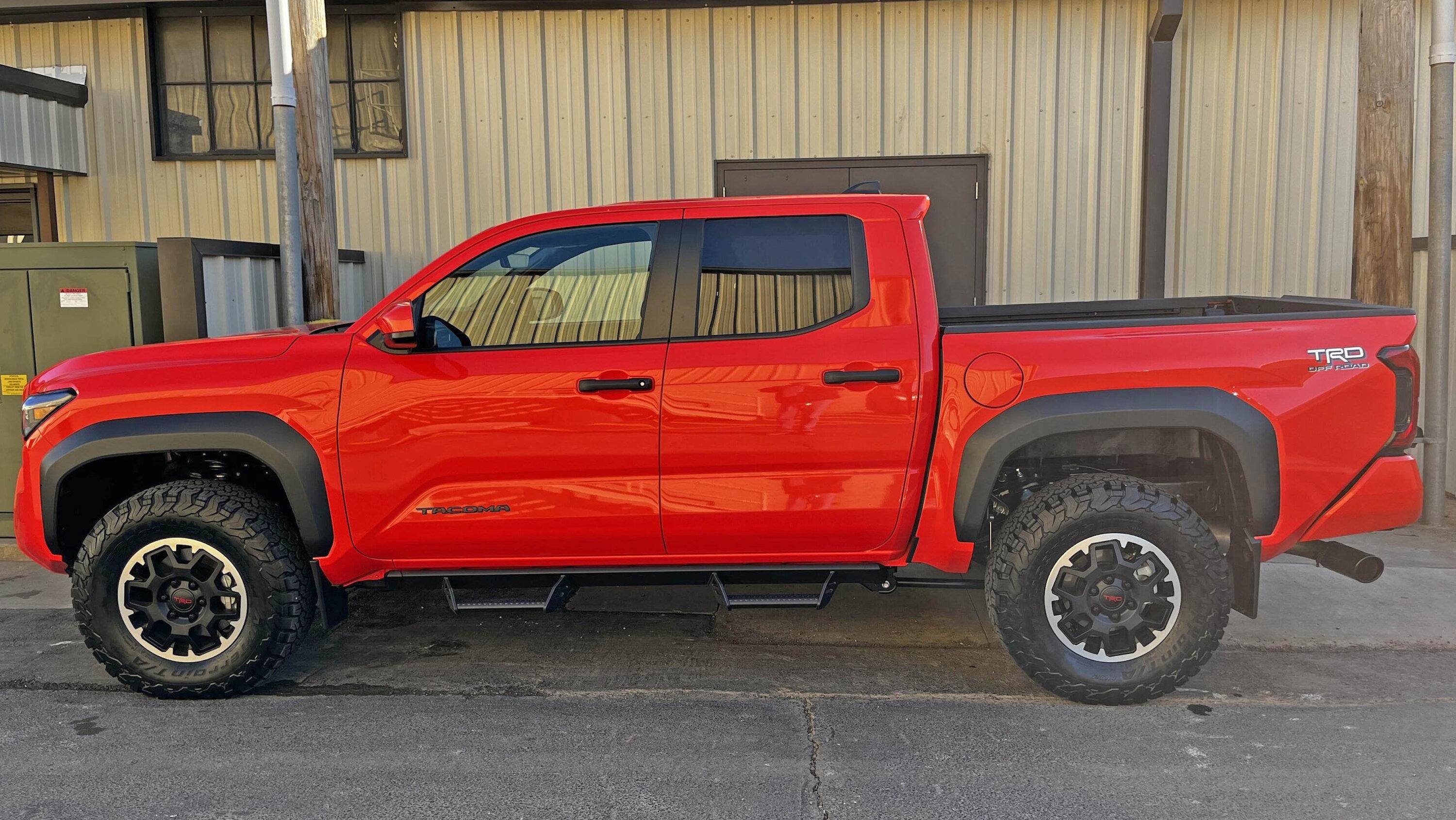

Tacoma owners have been able to fit 285/70/17 tires on stock suspension -- with no lift kit, no rub and no other mods needed.
https://www.tacoma4g.com/forum/thre...-no-cab-mount-removal-2024-trd-off-road.2185/
Looks great too on this TRD Off-Road. These are BFG KO2 tires in 285/17R17.
285/70R17 are ~32.7" in diameter, which are only ~0.1" greater in diameter than the stock tires on my 4Runner ORP. However, I might get a set of 17" wheels for my next set of tires, probably with a slightly wider offset. So, I might end up with this size tires in KO3s, or something a little bigger if I do a lift. I think the OP wanted to stick with the 20" Sport wheels.
