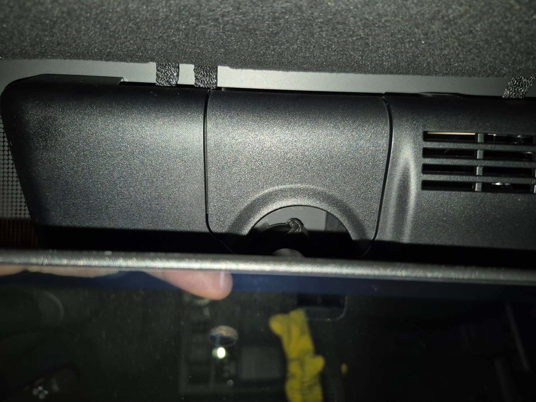

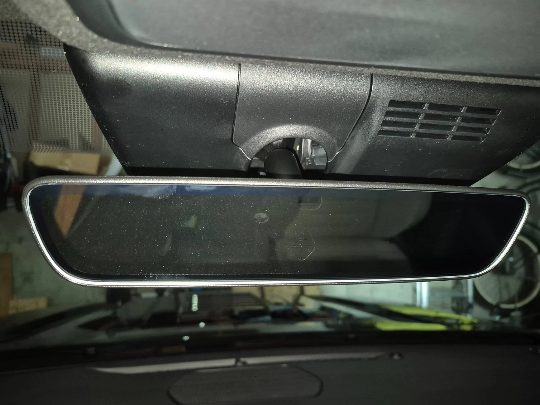

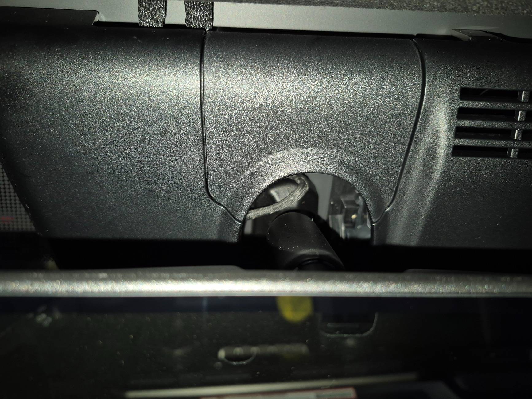

Update:
So I researched more, purchased a mirror, and installed it. I made a YouTube video of the process... I hope this helps someone...

Hello! Brand new member here, just purchased a 2025 TRD Sport yesterday. I’ve only driven it a few miles, and so far, it’s fine... but I took a slight downgrade from my current 4-Runner, which is a 2015 SR5 Premium. I’ve given up the sunroof, Softex seating, and, unfortunately, the HOMELINK openers on the rearview mirror.
I want to immediately get a HomeLink opener my new 4Runner. I’ve rigorously searched this forum (for a few hours) and have not been unable to find much regarding upgrading this feature. The dealer did NOT have any options for me.
I have found these guys.... https://www.bobsmirrors.com/?AffId=2
But I’m unable to find information regarding the following:
How do you remove the black trim/console around the mounting area of the mirror? It actually
seems a little flimsy, and I really am concerned about breaking it.
Is there a “ready to clip into” power supply so a new HomeLink mirror will be plug and play?

Nice job! I feel like having the auto-dimming mirror with home link and the rear power lift gate should be a standard feature in all modern SUVs. It’s like power windows and door locks andinsane that they would only be included in premium trims.

Didn't notice your DIY video update until the feature on the homepage. This should be very helpful to owners who didn't get Premium packages.

You can tap into the embedded OEM dashcam plug in the ceiling pod for power even if there is no auto dimming mirror from the factory. Super simple to do
Do you happen to have any pictures showing where the release clips are for the overhead pod? Don't want to break the plastic taps. Helps to know where they are and which way to pry.
Thanks if you have the information.
