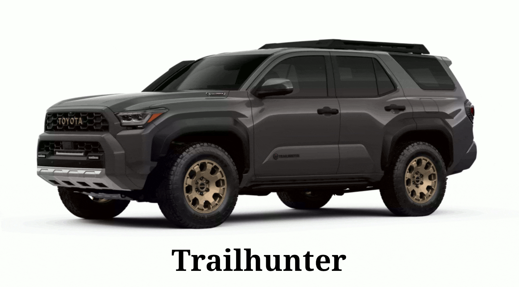

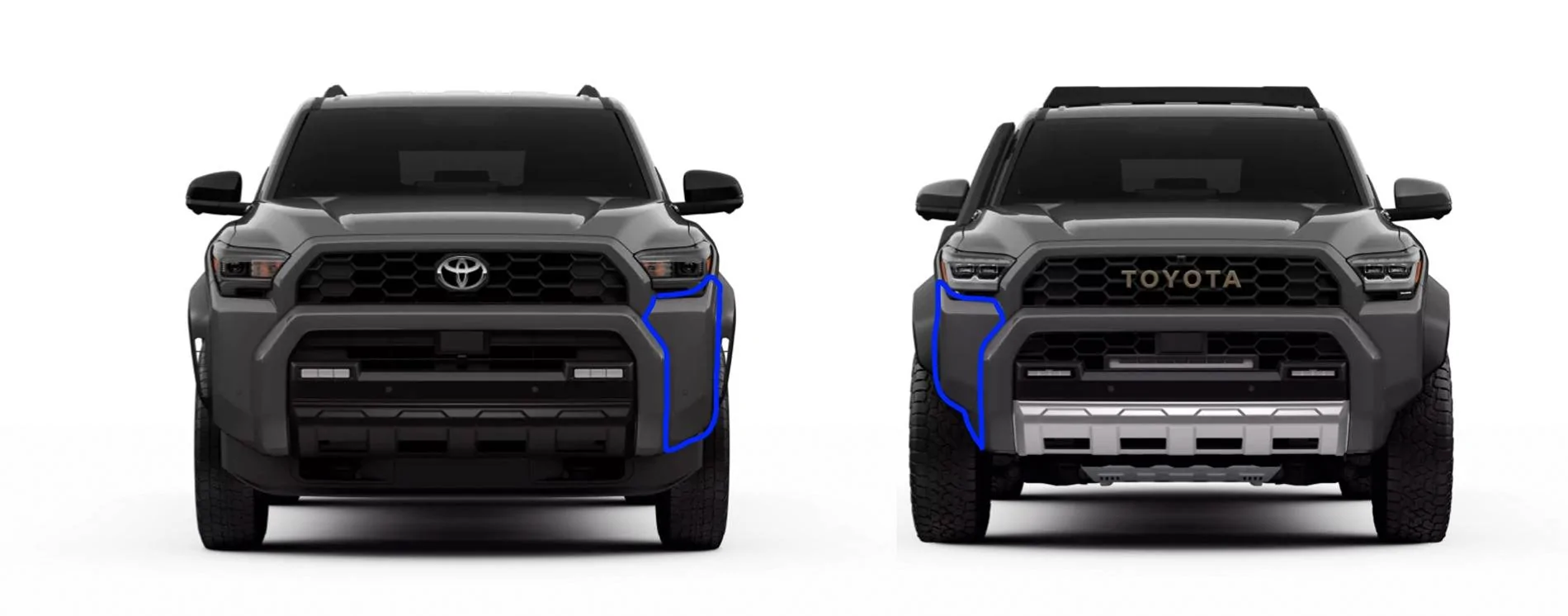

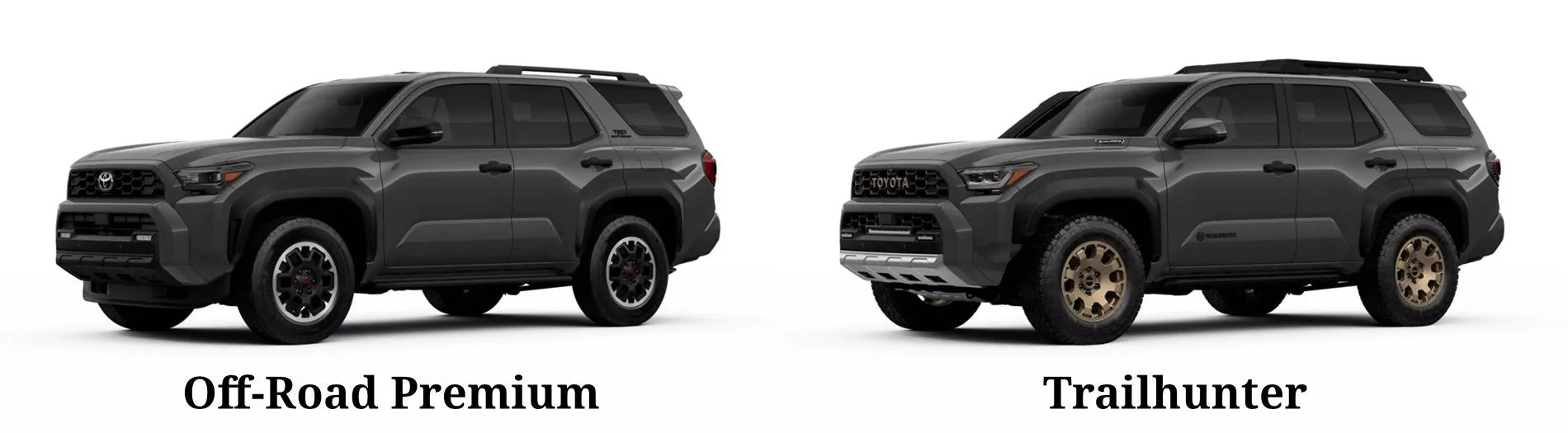

I posted pics in my previous comments to compare the two in Underground.
Thing's I notice:
  • Grill. The ORP has the smaller Toyota logo while the Trailhunter has the larger "Toyota" letters. Trailhunter has another light between the foglights (maybe just different color paint)? I think the trailhunter looks a little nicer there.
  • Front bumper: Silver on Trailhunter. Black on ORP. I'm mostly indifferent on this one, but think the black looks slightly better.
  • Air damn: Present on ORP (can be removed easily). Not present on Trailhunter. I plan to remove this for clearance reasons. I also think it looks better without it. There will be a slight decrease in fuel efficiency if you remove it.
  • Head-lights/Tail-lights: Smoked effect on Trailhunter, clearer on ORP. Trailhunter looks a little better to me, but not by much.
  • Side badge location: Front door on Trailhunter. Behind rear door on ORP. Not sure I care about this at all.
  • Snorkel: Present on Trailhunter. Not present on ORP. I think it looks weird, but serves a functional purpose (not something I think I will personally need enough to add on). I read somewhere that it's more about road dust than water clearance.
  • Fender flares: Different design and possibly bigger on Trailhunter. I noticed the ORP has the front fender flare vents and the Trailhunter does not. I assume they are wider to accommodate wider wheel/tire spacing. This is something to consider if you are upgrading the wheels/tires. I'm not sure I personally care about this one either, but the Trailhunter will probably kickup less road grime than an ORP will with the same width wheel/tire combo.
  • Tires/wheels: "Bigger" on trailhunter and wheels are a different color. The gold wheels look cool, but I like the stock wheels too. I pan to pickup another set of wheels for swapping winter/summer sets. I don't think I'll get this gold color (maybe the all-black ones).
  • Rocksliders/running-boards: Hard to tell in pic, but I think you can see the rock sliders on the Trailhunter. I think you can pick this up for ~$800, but I'm going to look into other aftermarket options.
  • Upgraded roof rack: Present on trailhunter. Not present on ORP. You might want to get a different one since this is a 3/4 length and only 165 pound dynamic load (770 static load is OK). I'm leaning toward Prinsu or Gobi. I've got a moonroof to consider too.
  • Rearview windows: Black on ORP. Body colored on Trailhunter. I like the black better.
It's interesting how the Toyota CAD images maintain the apples-to-apples perspective, but the Trailhunter should ride a little higher with its stock tires.

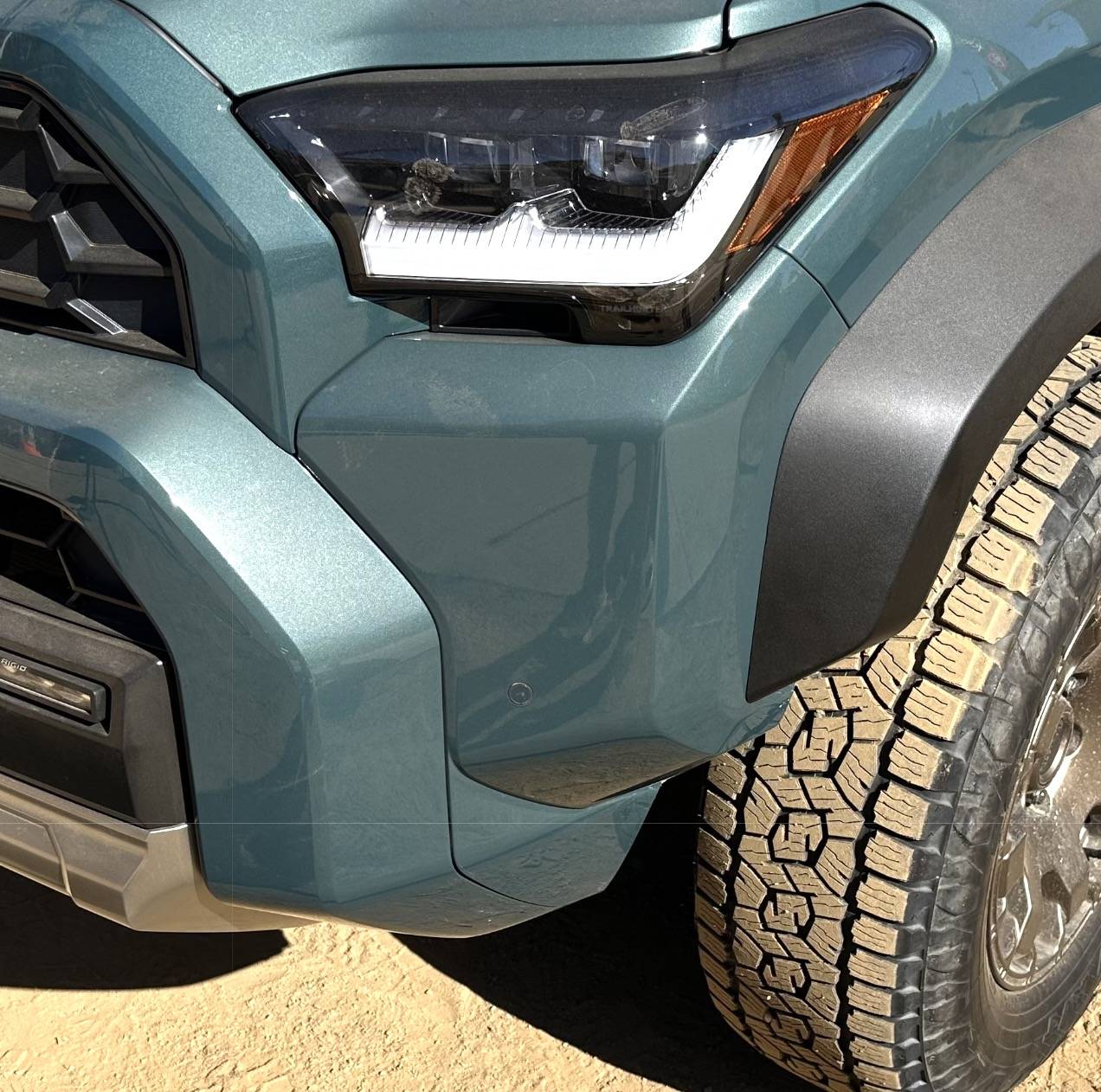

Anyone know if this part of the bumper is a separate element that can be replaced for the version of the Trailhunter and the Pro that has more clearance?
Interesting question. There does appear to be cutlines on around that part of the Trailhunter bumper. But whether that piece detaches or is available to be purchased as a separate part is another question.

Thanks for this close up view of it @Gastan ! Looking at this it does seem likely that someone will figure this out soon, whether using OEM or aftermarket mods
