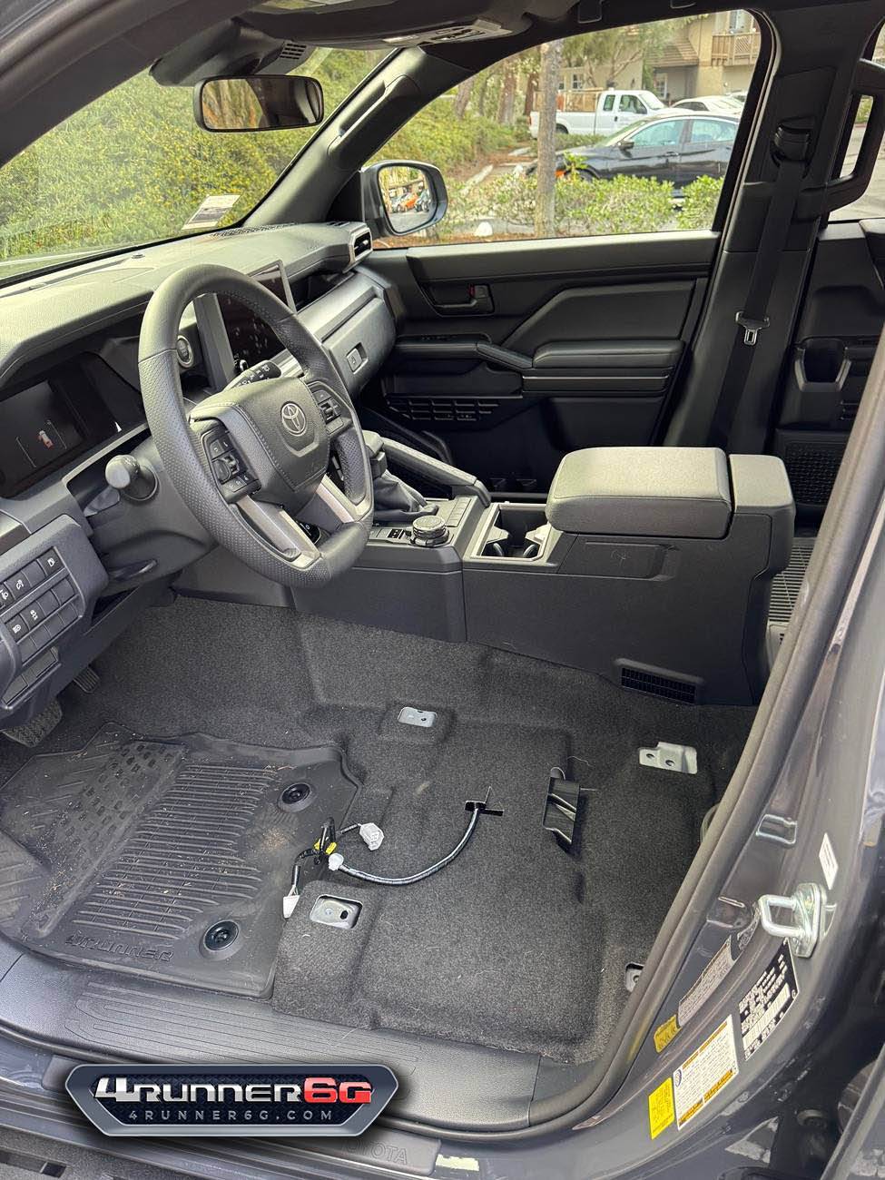

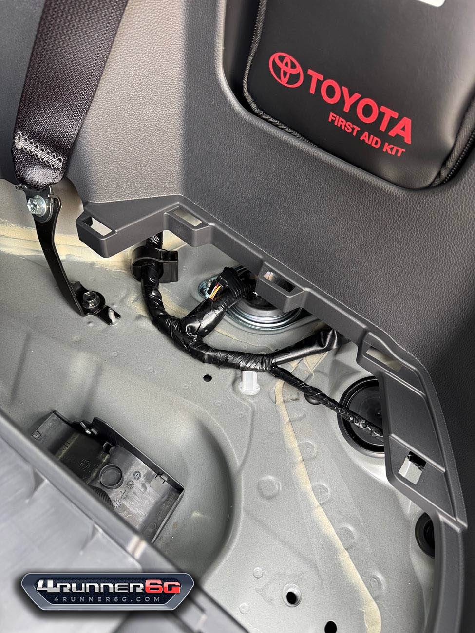

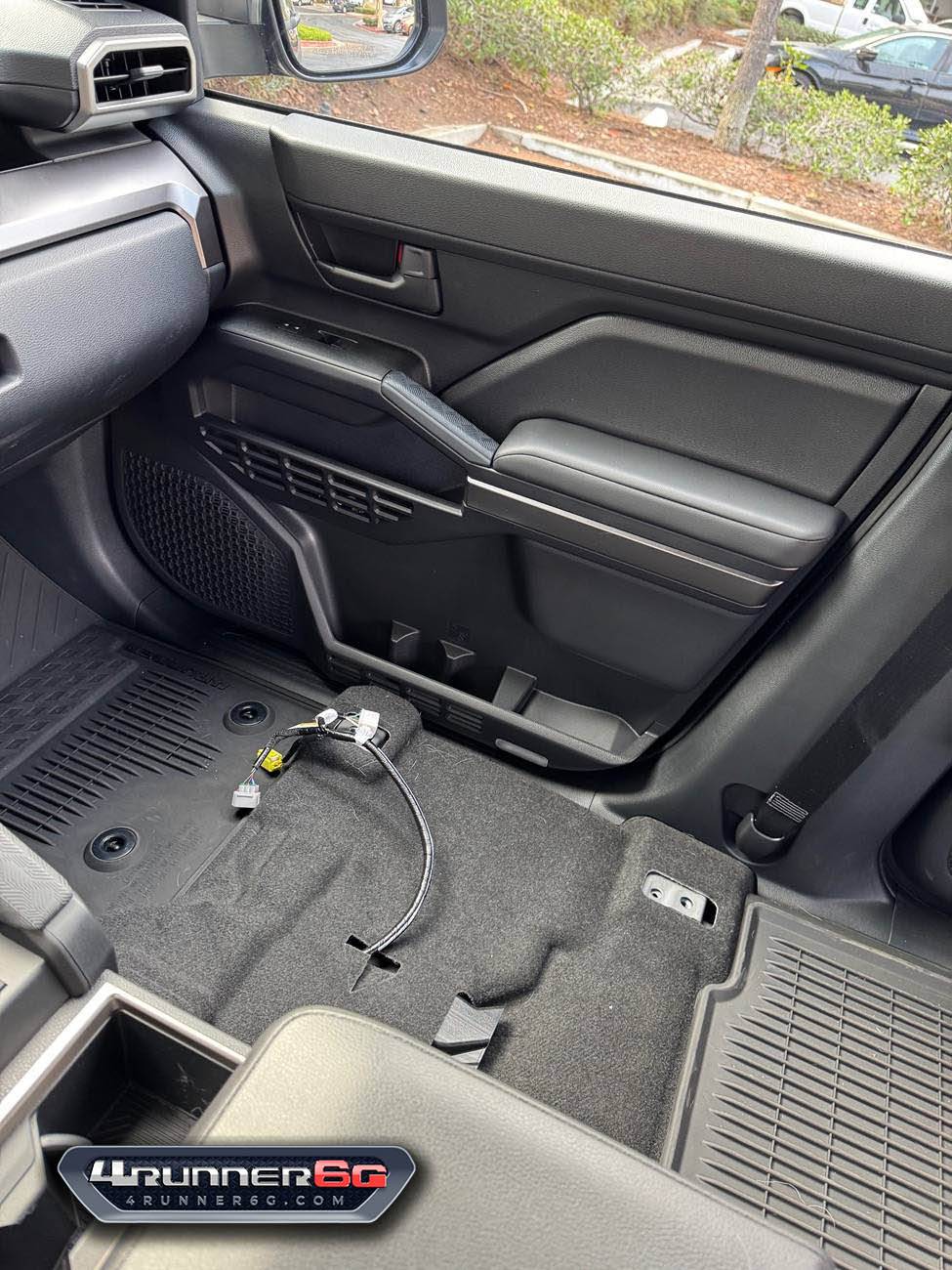

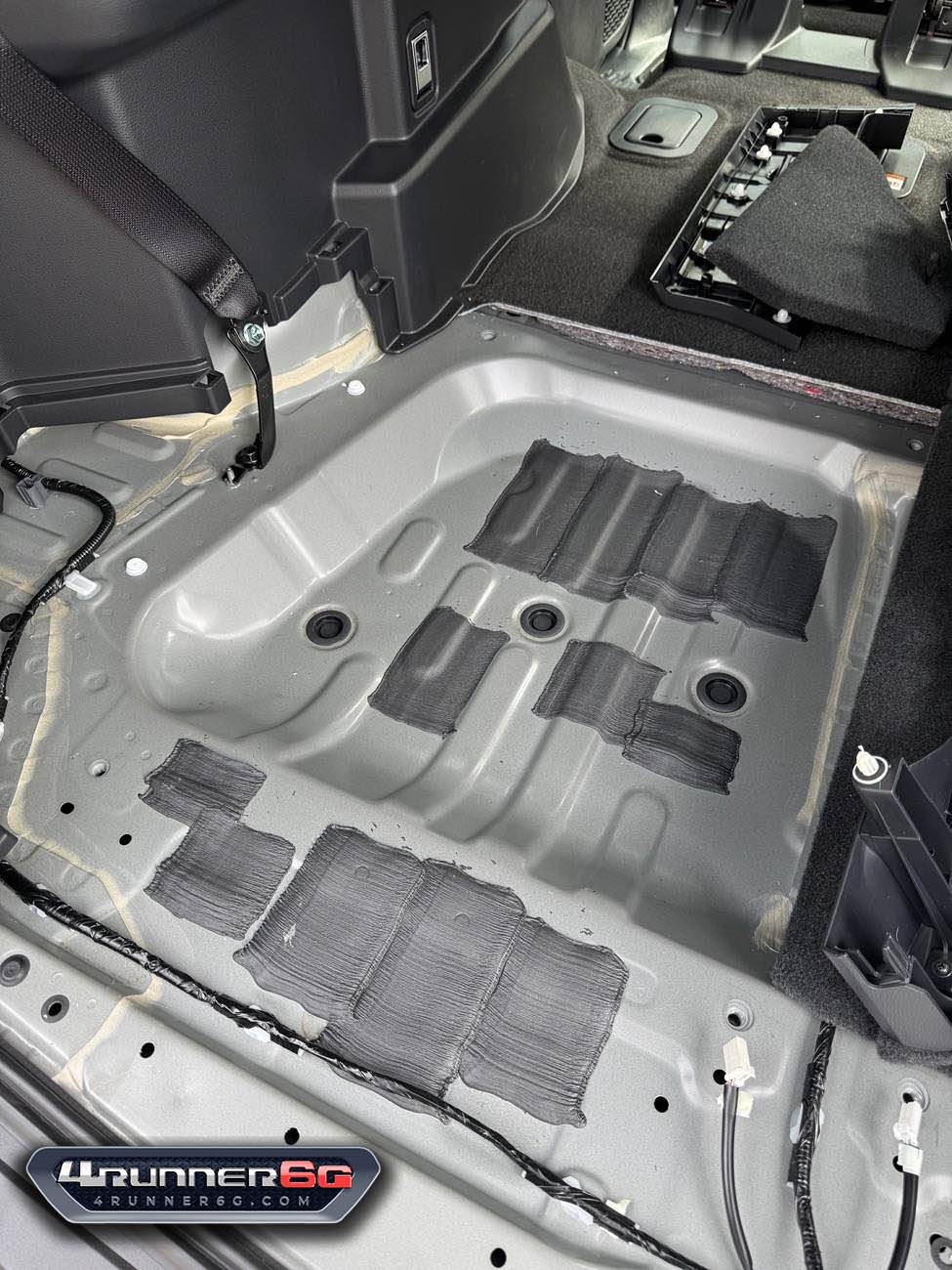

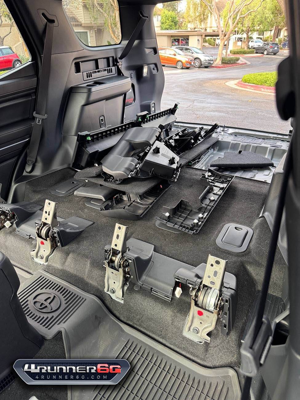

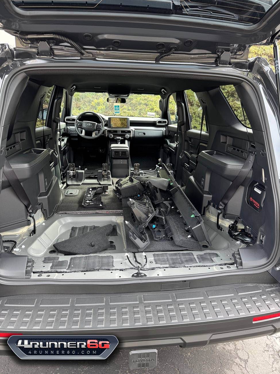

Yea @Kokorone posted pics of all seats - first row, second row and third row all removed from his 2025 4Runner
Here's the thread:
Seats removal (1st, 2nd, 3rd row) from 2025 4runner 6th gen - photos
https://www.4runner6g.com/forum/thr...rd-row-from-2025-4runner-6th-gen-photos.2325/
Photos from that thread
2025 Toyota 4runner Removing 2nd row seats img_0964-
2025 Toyota 4runner Removing 2nd row seats img_0965-
2025 Toyota 4runner Removing 2nd row seats img_0963-
2025 Toyota 4runner Removing 2nd row seats img_0966-
2025 Toyota 4runner Removing 2nd row seats img_0968-
2025 Toyota 4runner Removing 2nd row seats img_0967-
2025 Toyota 4runner Removing 2nd row seats img_0969-

Can those attachment points/hinges that stick up also be removed to reach a flush surface?

I was disappointed that the rear floor doesn't provide easy access to the extra space below it on the non-hybrid 6th gens. The photos reveal there is some useful stash space below. Has anyone figured out an easier way to access it? Maybe someone will produce an aftermarket floor with hinged access.

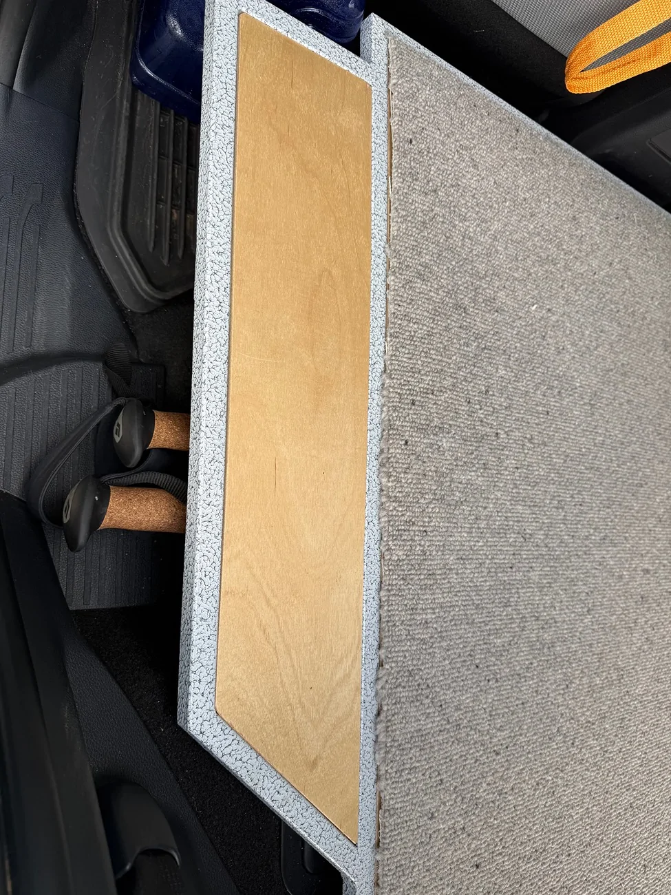

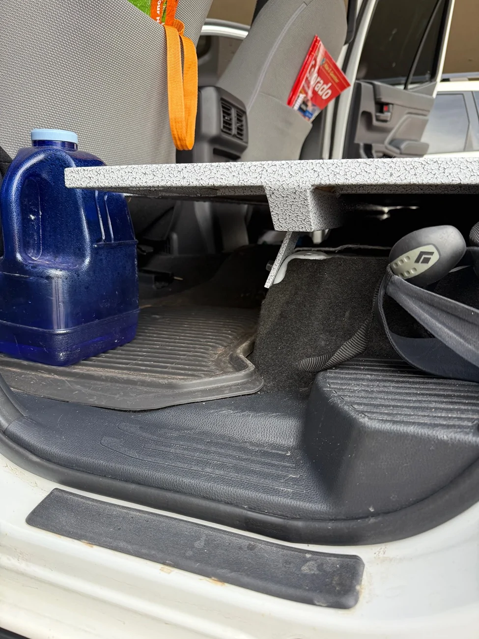

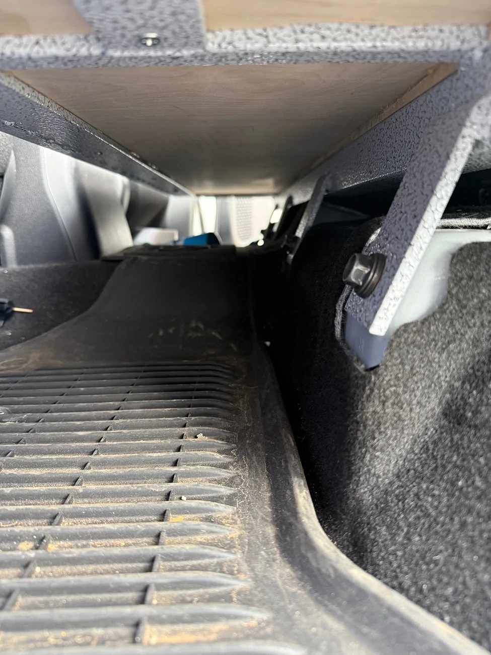

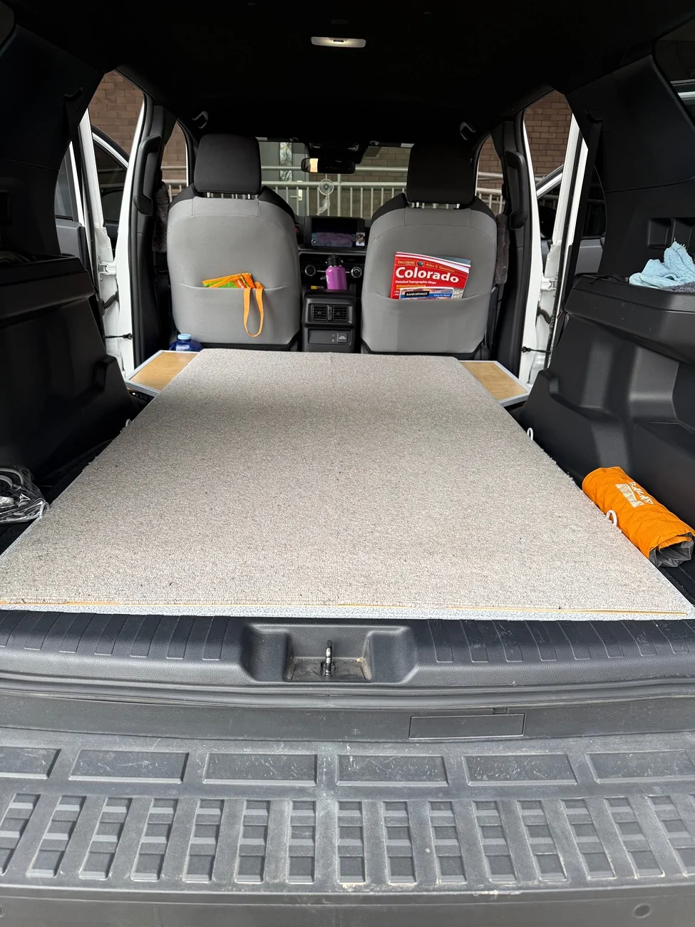

Yes, I just removed the entire assembly and it leaves you with a flush floor.
I’m having a nice platform fabricated. When it’s finished I’ll post some photos.

The 2nd row seat brackets are pretty simple to remove. You just have to remove the seats which are 4 bolts each and then take off the remaining plastic shroud and it’s another 6 bolts for each side.

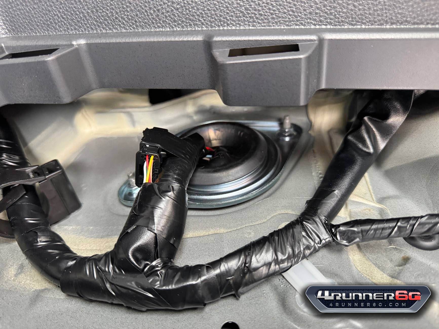

Glad it’s just as easy as the 5th gen. Did you have any issues after removing the wiring harness for the rear passenger detection? I’m hoping there isn’t an annoying error light on the dash. As it is, too many distracting notifications.
It does throw an error if you have the seats removed. Unfortunately while you can “clear it” with the main infotainment the error is not removable from the history log there.
I’d assume that if you put a resistor in series with the connector it’d suffice to shut up the warning
