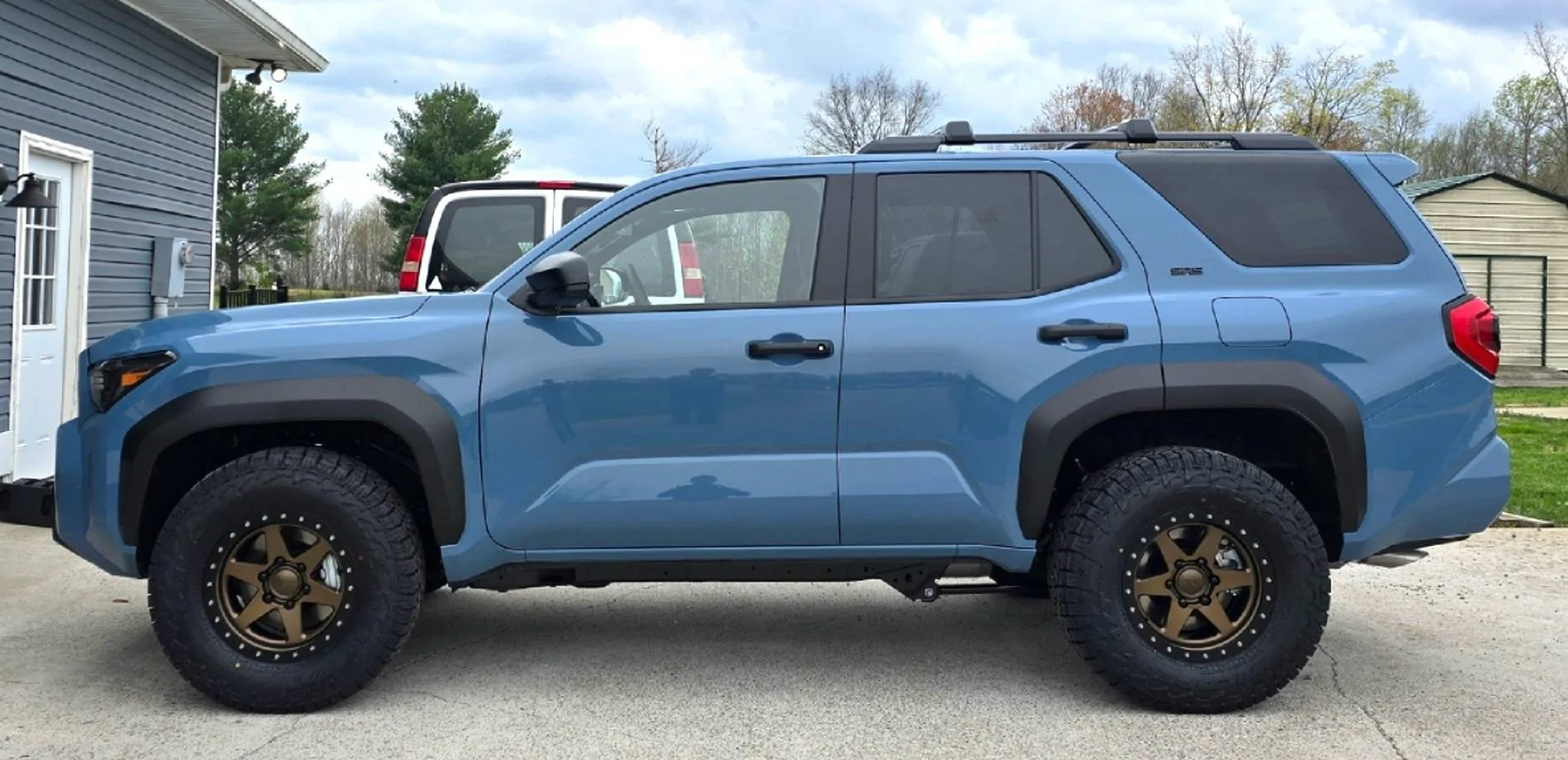

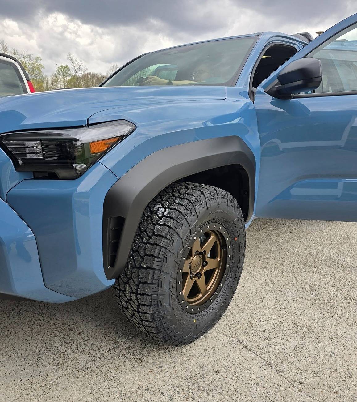

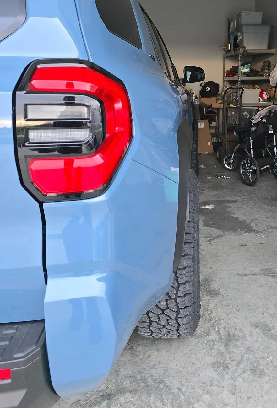

Not mine (still waiting on my Trailhunter), but this is good to know for SR5 --
Wheels: Stealth Custom Series BR6 matte dark bronze. 17x8.5 +25 offset
Tire: 285 70 17 Wildpeak AT4W
No lift, no rub at all
No other mods

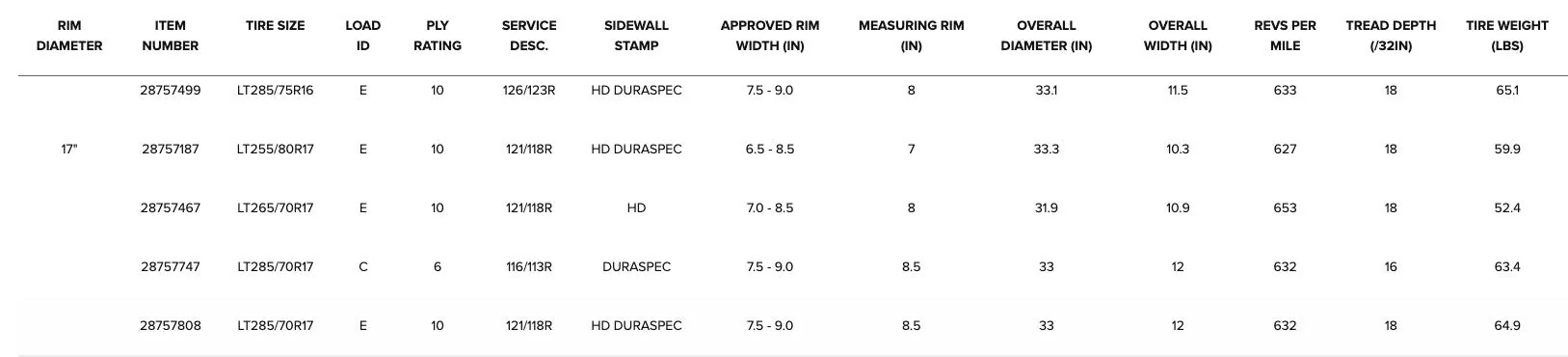

Looks Great! i am wondering what is the load rating of these tires? SL or C?

They come in C or E load https://www.falkentire.com/wildpeak/at4w
2025 Toyota 4runner Stock SR5 on +25 offset wheels and 285/70R17 Wildpeak AT4W tires - no lift, no rub 1743525597817-33
C Load is recommended for a softer ride. You can take E Load if you really need the extra toughness (super heavy weight loads or extreme offroading), note the E Load tire is a heavier tire => less MPG.
