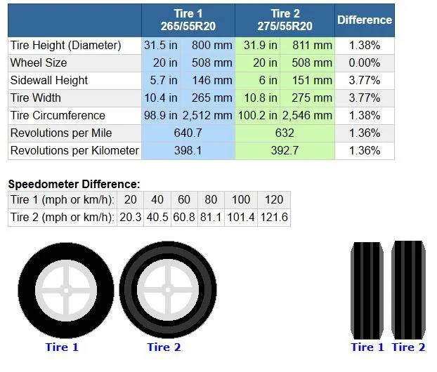

@nubbins_ A bit off topic but I will ask, the TRD Sport model has a somewhat limited tire size: 265/55R20
When you try some online tire stores, you don't get much results for that size.
Would you have any similar size to suggest that would still fit the factory 20 inches rim and the 4Runner 6th gen while not fooling too much the odometer?
