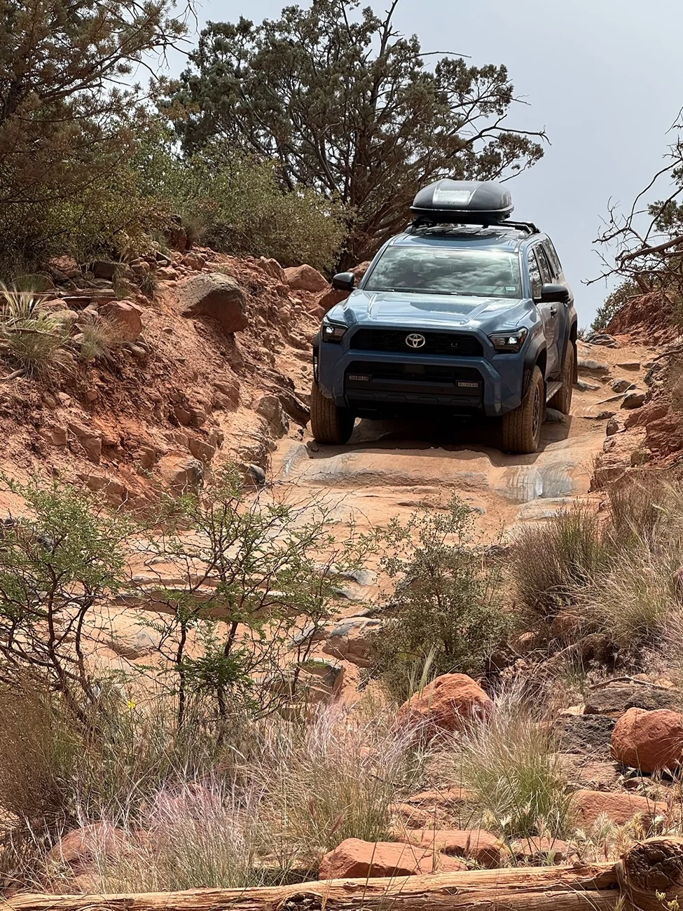

Oh it’s been great. I’ve done about 7k miles since install. I feel the right quality feels the same as stock, but the stance looks great. The extra clearance came in handy hitting trails in Arizona and California. I did have the alignment done after install. It wasn’t awful, but it should’ve been done.
2025 4runner 6th gen Best level kit that maintains best ride quality? IMG_7020
