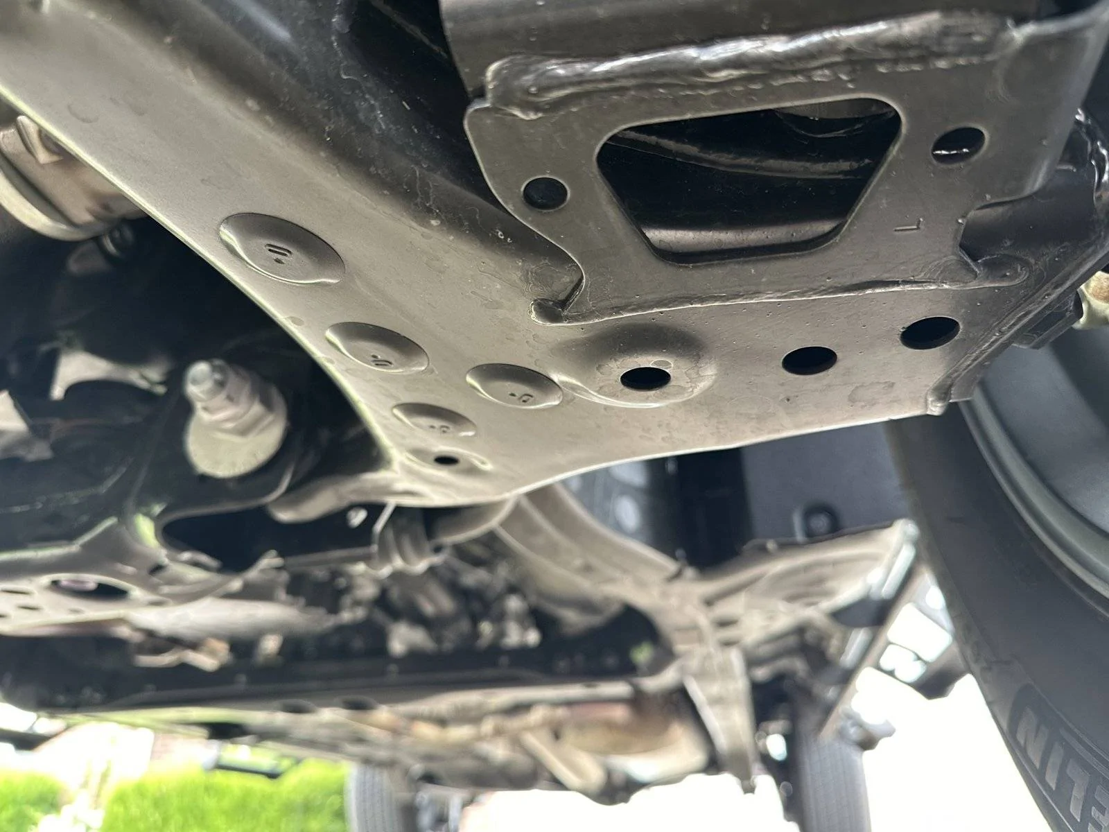

Here is a post from Tacoma World on this issue so I would assume the same is on the 4 Runner. There are 4 holes on the lower control arm that needs plugged. You can buy the plugs from Toyota or from Amazon. Some models come with them and some dont. Here is a picture of the control arm and a link to the thread. I had the noise on mine after removing the air dam and the plugs fixed it.
Noise after removing air dam | Page 4 | Tacoma World
2025 Toyota 4runner Whistling noise after front air dam removal: final verdict? plugs
