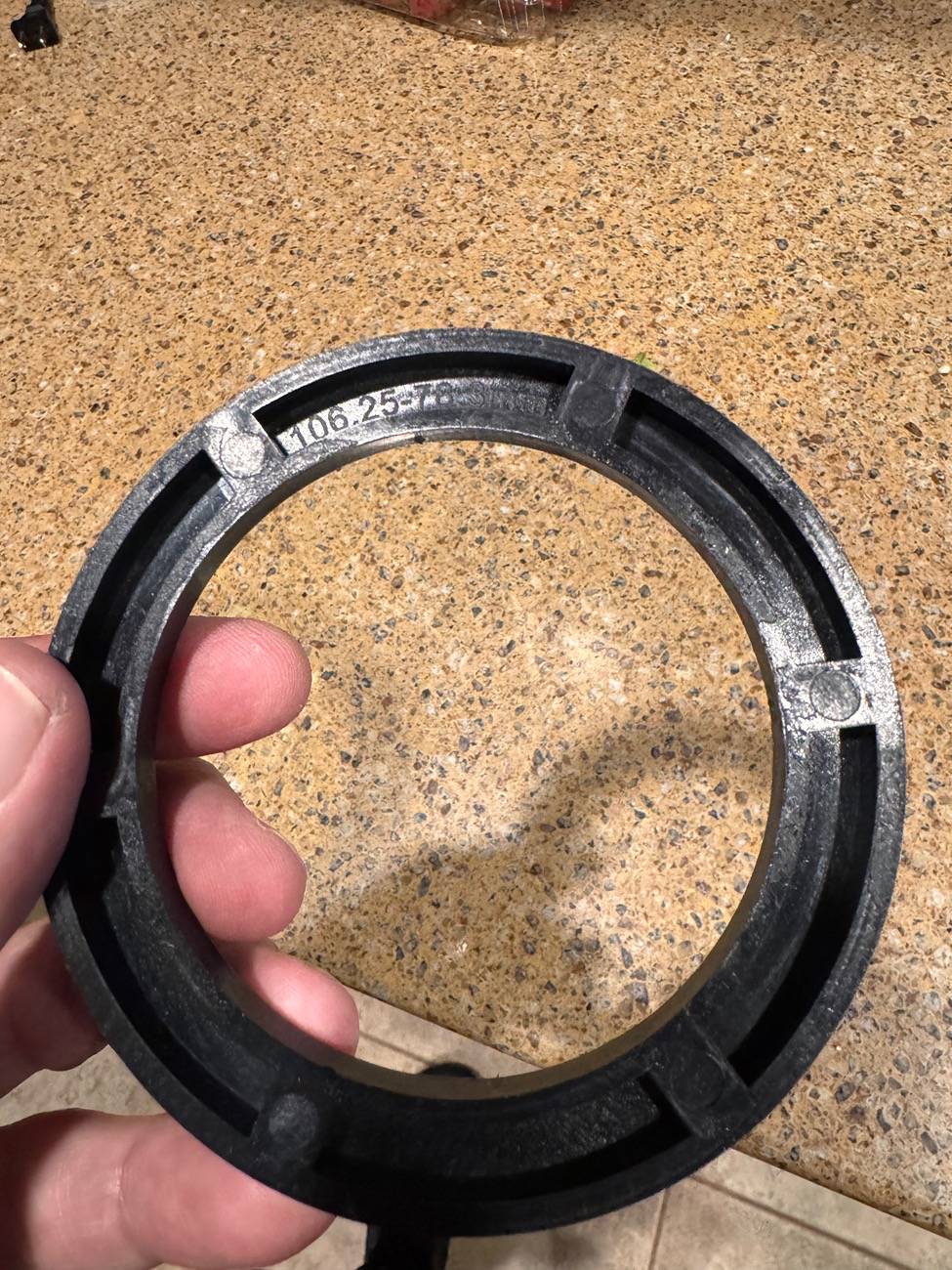

Any wheel experts on here that can verify this but I called Method because I was showing 106.25mm Center bore on the wheels I received I spoke with the manager he said there wheels are lug centric and this wont matter. I am not a wheel expert beyond sizes and offsets/back spacing so I hope hes right.

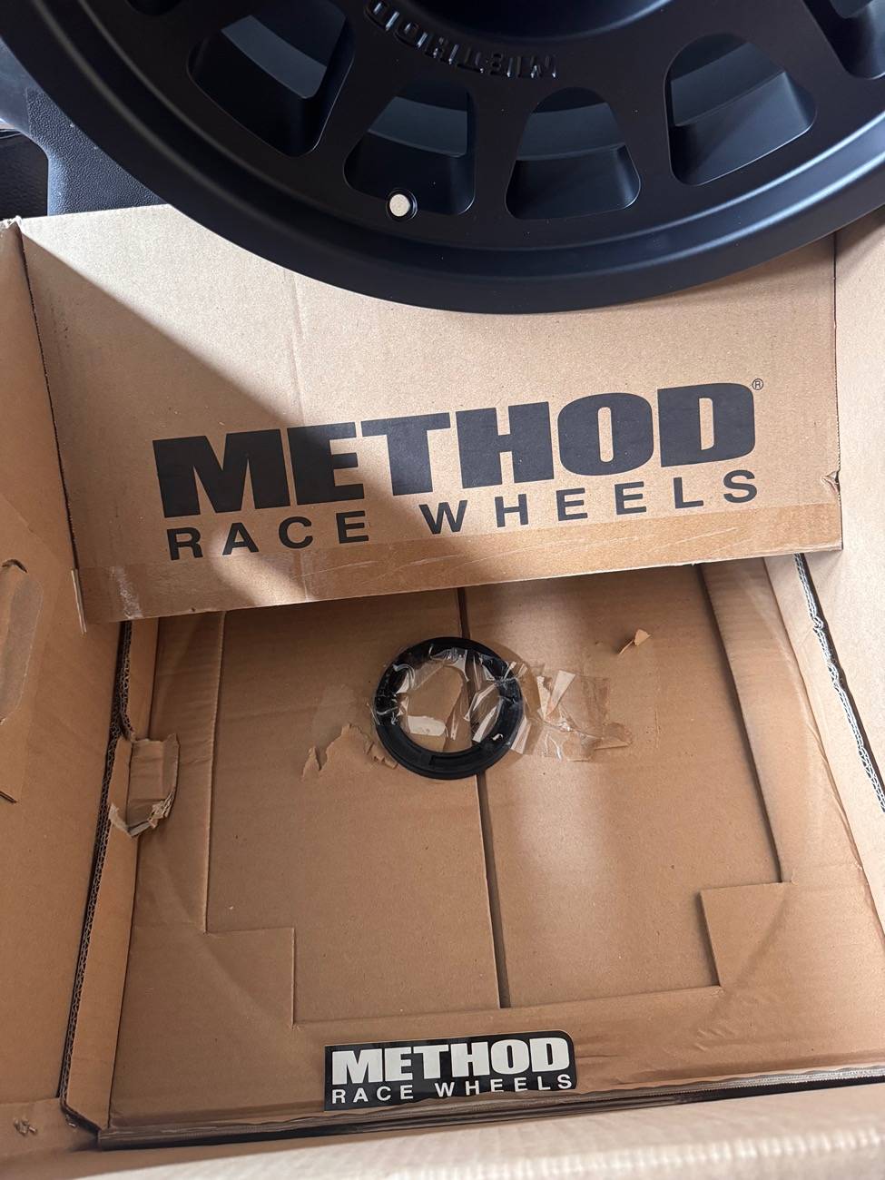

Found the rings under the wheel affixed to the box. Def wrong size.
