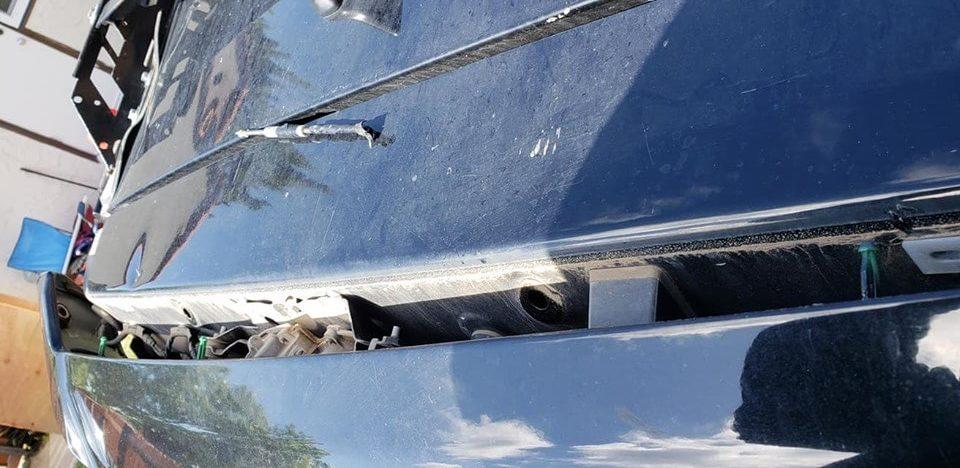

Here's one rear camera dashcam installation on a 5th gen -- this is a BlackVue Dash Cam.
2025 Toyota 4runner Mounting locations for rear view camera in a 2025 4Runner? rear view camera dashcam install 2025 4runner 6th gen 2
2025 Toyota 4runner Mounting locations for rear view camera in a 2025 4Runner? rear view camera dashcam install 2025 4runner 6th gen 1

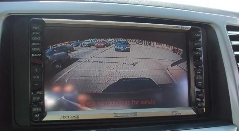

And another rear view camera install on 5th gen
2025 Toyota 4runner Mounting locations for rear view camera in a 2025 4Runner? 800d1275947897-evolution-jacs-4runner-eclipse-0333
2025 Toyota 4runner Mounting locations for rear view camera in a 2025 4Runner? 804d1275948708-evolution-jacs-4runner-eclipse-0300

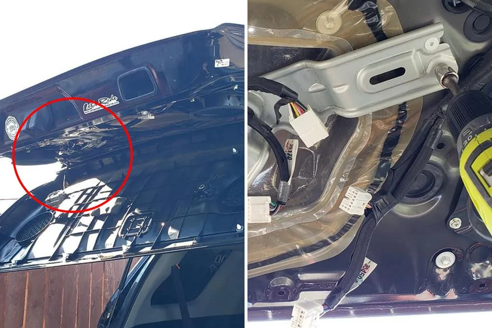

And another option -- rear view camera mounted on the rear spoiler. Should be possible on the 6th gen 4Runner's rear spoiler too.
2025 Toyota 4runner Mounting locations for rear view camera in a 2025 4Runner? 5th_gen_4runner_rear_camera_re_location_23-
1. OPEN REAR HATCH DOOR & REMOVE GROMMETS & BOLTS
2025 Toyota 4runner Mounting locations for rear view camera in a 2025 4Runner? 5th_gen_4runner_rear_camera_re_location_step_01
Open the rear hatch door and look for the four grommets on the top. Remove the grommets and unbolt the four bolts.
2. CLOSE THE HATCH & REMOVE SPOILER
2025 Toyota 4runner Mounting locations for rear view camera in a 2025 4Runner? _4runner_rear_camera_re_location_04-e1559178251560
Remove the spoiler using picking tool, plastic pry tool or a plastic panel removal tool.
3. UNPLUG WIRE FOR BRAKE LIGHTS
2025 Toyota 4runner Mounting locations for rear view camera in a 2025 4Runner? _4runner_rear_camera_re_location_05-e1559178625841
Unplug the wire brake light. Then, set the spoiler to the side for now.

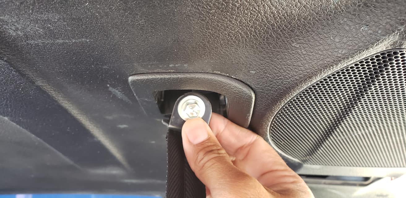

4. OPEN THE HATCH & TAKE OUT HANDLE
2025 Toyota 4runner Mounting locations for rear view camera in a 2025 4Runner? 5th_gen_4runner_rear_camera_re_location_06
5. REMOVE DOOR PANEL & REMOVE BRACKET
2025 Toyota 4runner Mounting locations for rear view camera in a 2025 4Runner? 5th_gen_4runner_rear_camera_re_location_step_05
Remove the door panel using the panel remover and the light. Then, remove this (silver metal thing) using a drill and 10mm open socket wrench.
6. REMOVE PLASTIC COVER & FIND (X6) BOLTS
2025 Toyota 4runner Mounting locations for rear view camera in a 2025 4Runner? 5th_gen_4runner_rear_camera_re_location_step_06
Remove the plastic cover. But, do not remove it all the way through.
Slightly remove the plastic cover to find and take out the 6 bolts, as shown in the picture above.

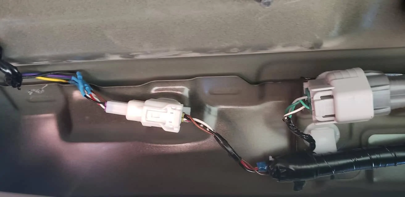

8. UNPLUG CAMERA POWER LINE
2025 Toyota 4runner Mounting locations for rear view camera in a 2025 4Runner? 5th_gen_4runner_rear_camera_re_location_13
Once bolts are removed, unplug the camera power line. Then, close the hatch, and then slowly remove the 4RUNNER sign.
Lastly, unscrew the camera housing and grab the camera.

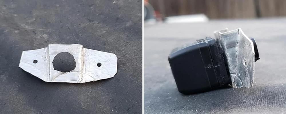

15. CREATE A CUSTOM BRACKET (OPTIONAL)
2025 Toyota 4runner Mounting locations for rear view camera in a 2025 4Runner? 5th_gen_4runner_rear_camera_re_location_25
I made a custom bracket to mount my camera.
To do this, I used my old license plate and cut a small piece, bent it to have it tilted.
Note: You can ask someone to hold the camera so you can test the angle.
