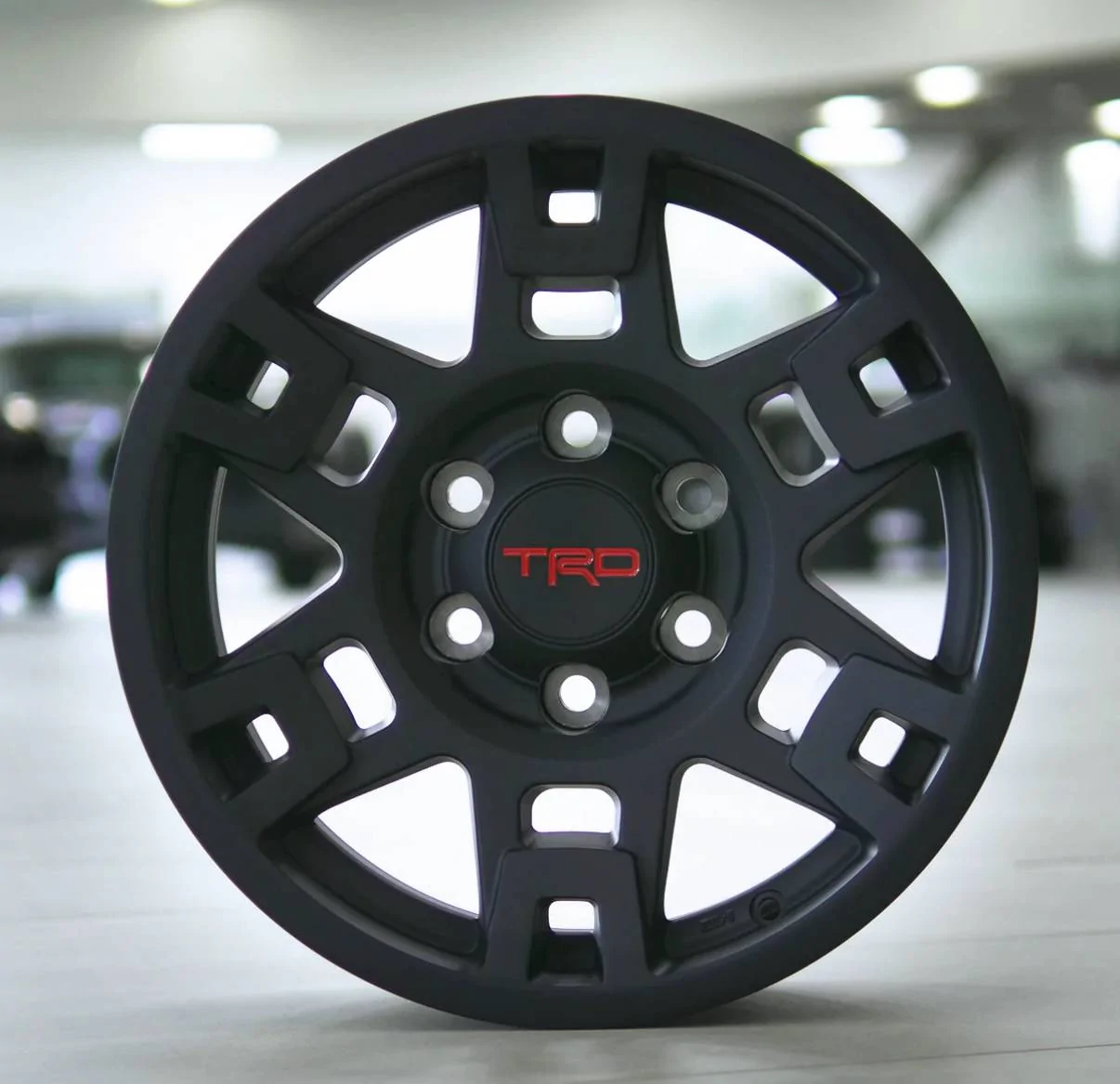

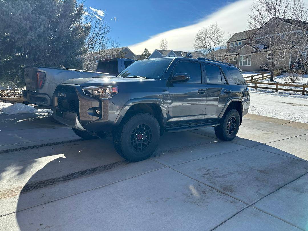

Has anyone tried fitting previous gen 17 inch TRD pro rims +4 offset onto their 6th gen 4runner?

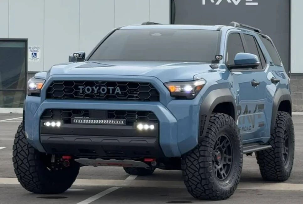

Rave offroad did and it looks badass. I have this set on my 5th gen and I'm tempted to swap them out lol.
Ah no way!! Thanks for sharing. Looks SO good. These TRD rims are superior to any new ones in my opinion. He looks lifted with big wheels eh? I’m wanting to put on a stock SR5 with only 265/70/17’s. Might have to buy and test the fit

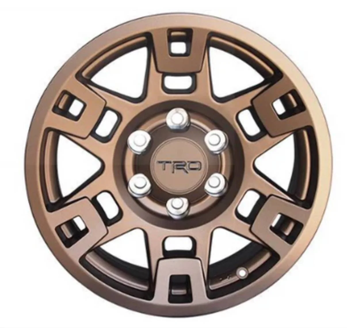

Can you please please confirm that these are the ones ?!
PTR2035110BK
PTR2035110F5
Been looking at these (As well as the bronze version) for the TRD ORP I have ordered in Underground, and this picture’s got me sold on that set ! (Might go with 285/70/17 if they do fit the stock setup.

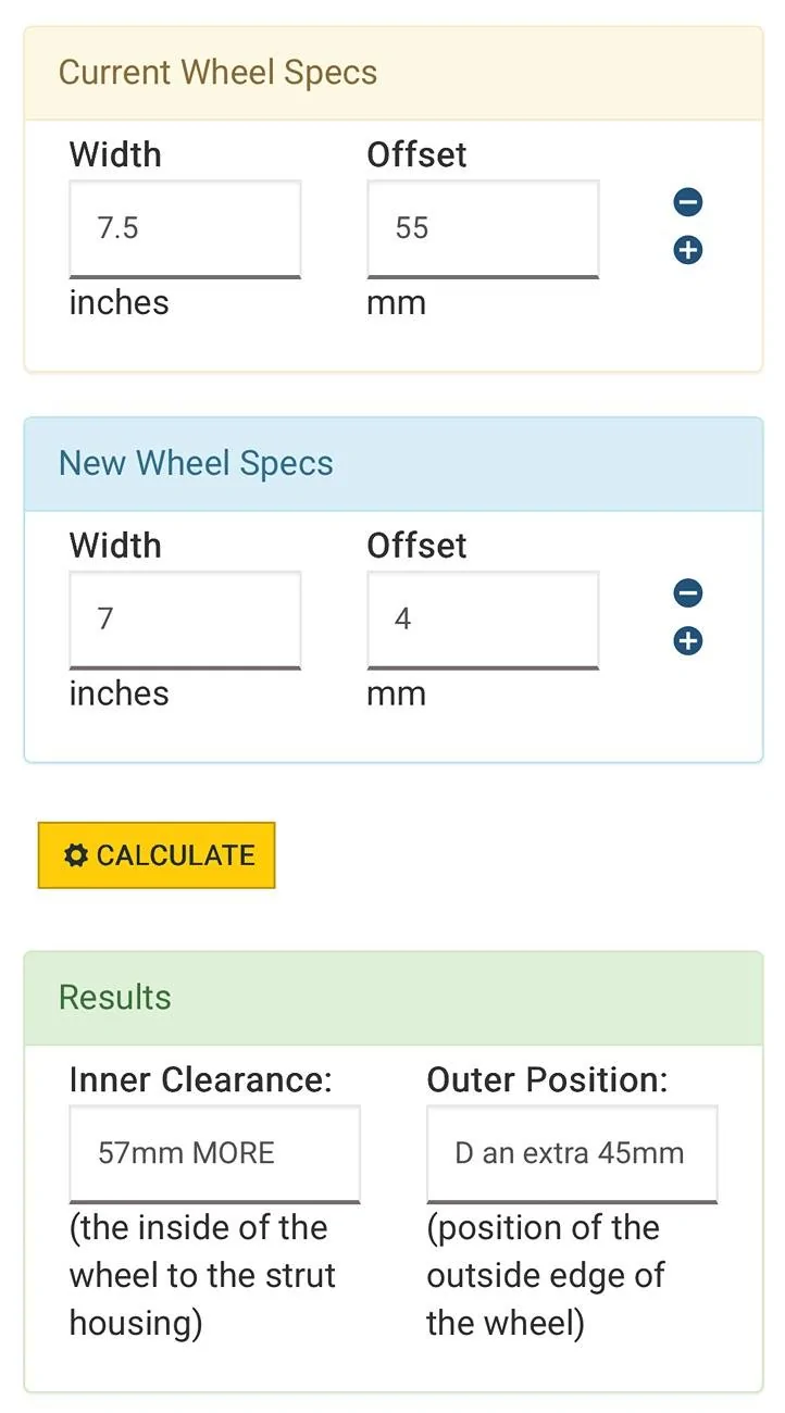

Well actually, based on the calculations I found here, the difference shouldn’t be « that bad », whith wheels extending an extra 45mm (the TRD ORP seem very tucked in IMO).
As for tires, I’m looking into possibly 285/75 R17 if they’re able to clear (which I believe they should based on my research here ?!), so not that skinny IMO :)

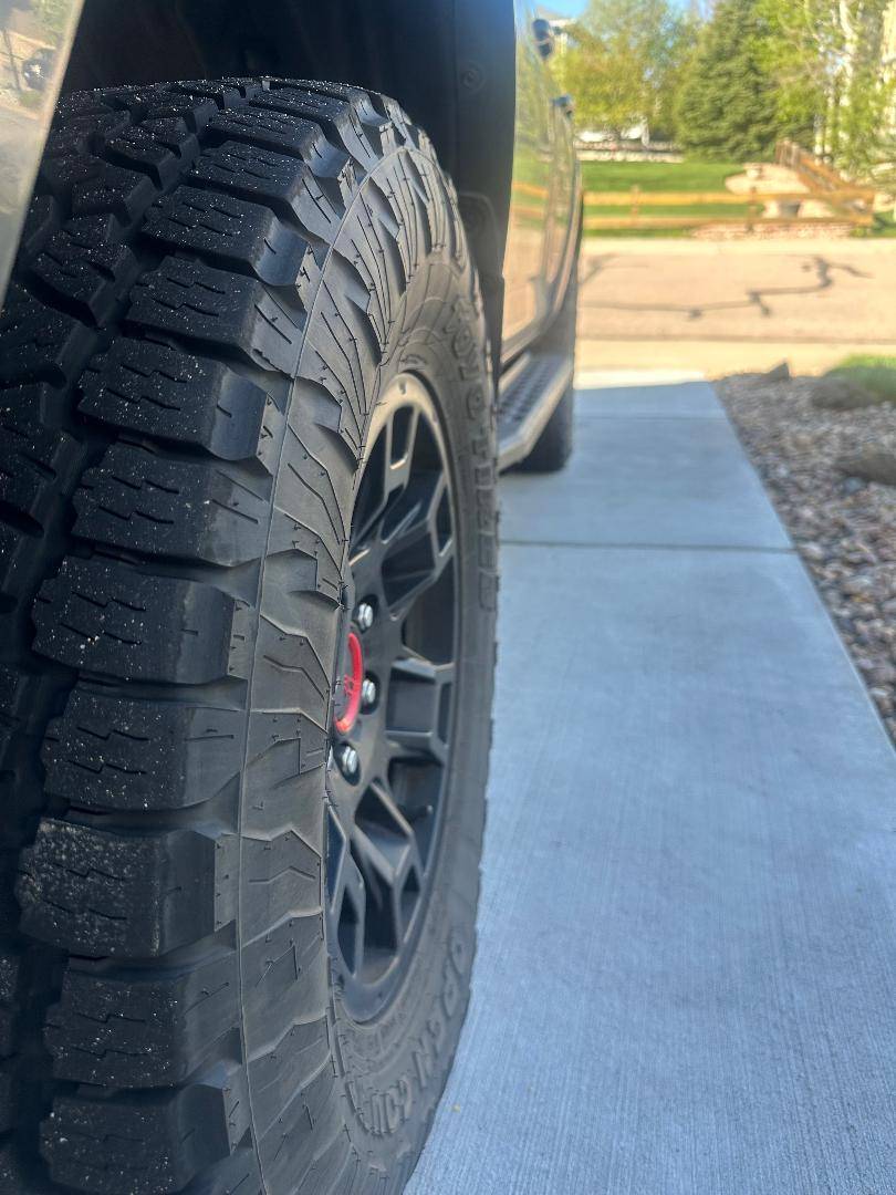

You're right it doesn't seem that much on paper with less than 2 inches but look at the TRD Pro rims with +25. For me the +25 is perfect size another -21 mm would be too much poke IMO. Also I think the 285 would be a lot for the 7 inch wheel too, here's a pic of ours with a 275/70/17 and it's close to too much width, the 285 has another 1/2 inch.

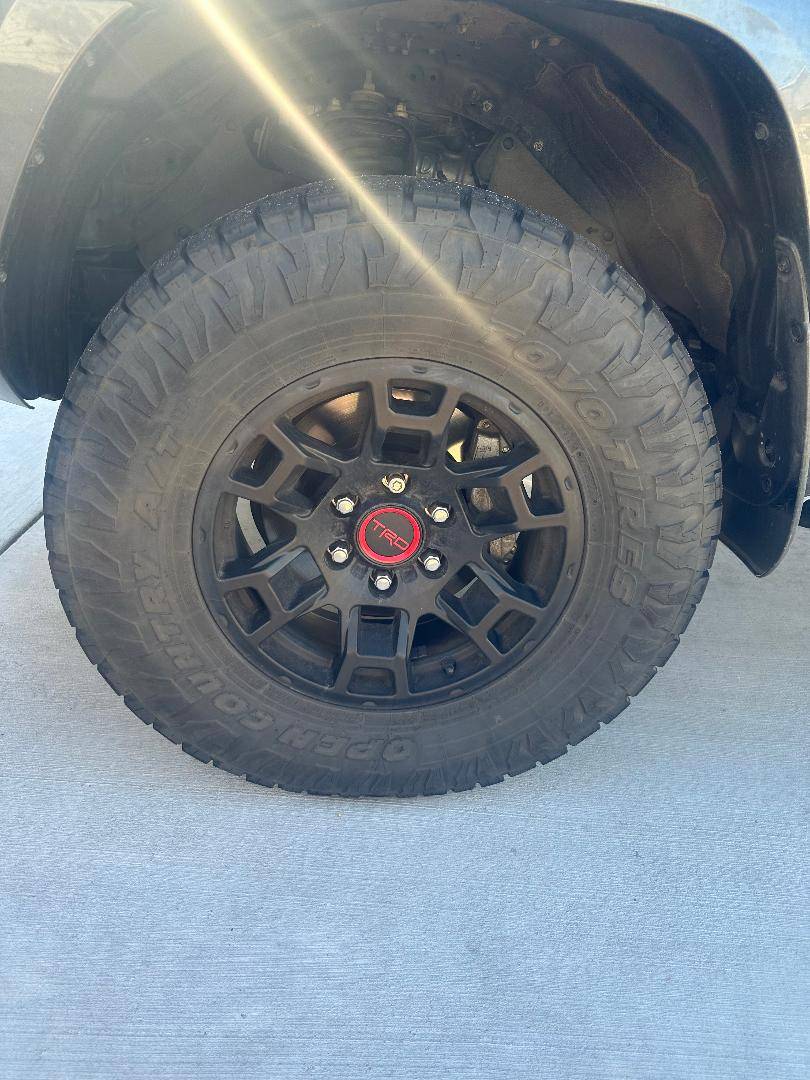

The pic is from my '23 TRDORP 4Runner, we haven't traded it in yet, but the wheels are '23 OEM TRD Pro 4Runner wheels, 17x7 +4 offset.
2025 4runner 6th gen Old TRD Pro rims on 6gen 4 runner? trd pro wheel 2
I don't have +25 yet still have the standard +55 18" TRD OR wheels on our '25 TRD OR Hybrid. BUT that's my plan is a TRD Pro wheel with a 285/70/18 and small lift once I burn through these Michelins.
