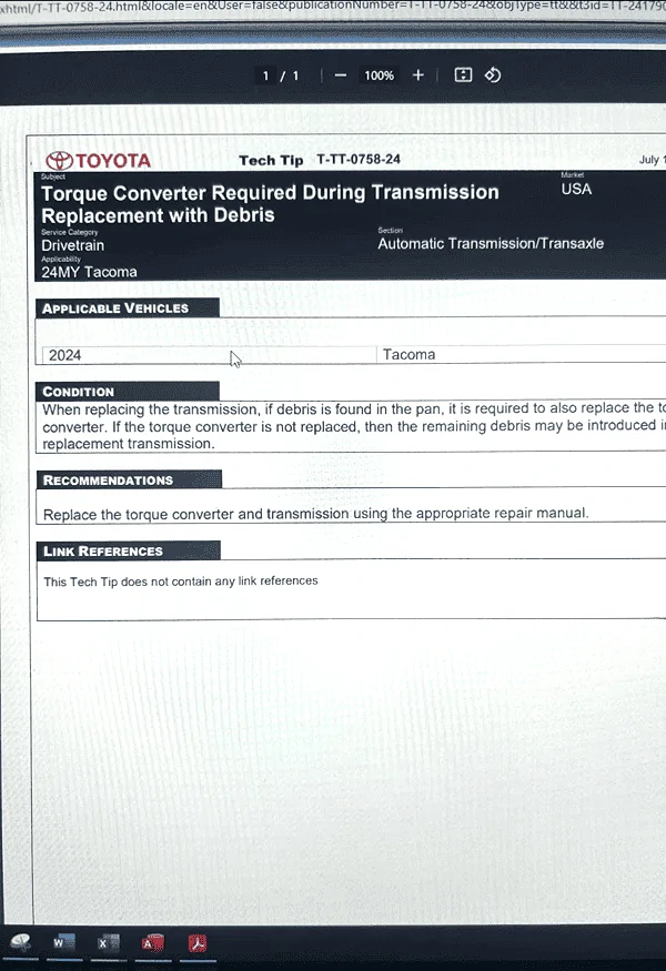

Transmission failures in 2024 Tacoma may be debris related
Marine
May 13, 2024
GTA, Canada
Obviously putting motor directly after trasmission is a high risk move.
They only told us pros but skipped the con part.
Torque matching and cooling will be challenging.
From the screenshot looks like the debris was from the torque convertor.
Marine
May 13, 2024
GTA, Canada
And judging by their turbocharged engine on tundra, new 4runner hybrid models can have TWO sources of debris from its powertrain.
