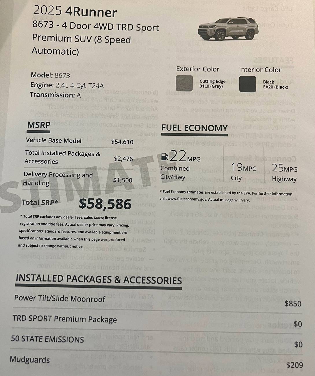

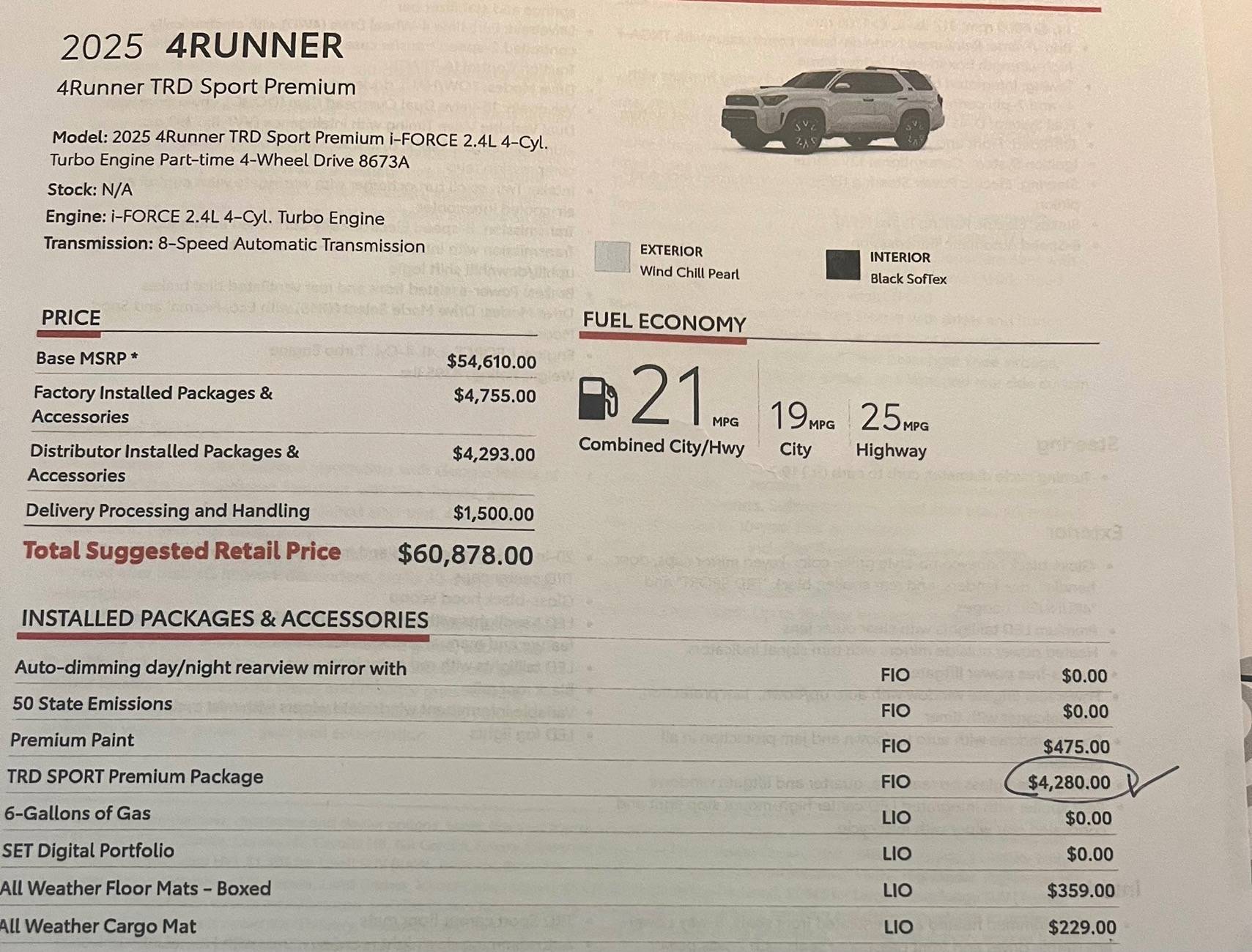

Any one notice or can help me understand why some spec sheets for a TRD Sport Premium Package F|O line item show $4280 and some show $0.
I've asked and dealerships with the $4280 tell me it's because of all the premium perks over non premium, but why is it $0 for other Sport Premium package?
2025 4runner 6th gen TRD Sport Premium Package pricing IMG_1994
2025 4runner 6th gen TRD Sport Premium Package pricing IMG_1992

cause the "trd sport prem" is a trim identifier so they know what to build out (zero cost cause it will define what is standard equipment in the build and it parts of the base msrp already)
FE option (50 state emissions) is federal requirement and already a sunk cost so it not additional cost but its required to be listed per federal rules (i think)
this will apply to most items that show as ZERO cost $0
the only option that doesnt follow this rule is the DK option (owners portfolio). its zero cost to the customer as shown on the window sticker (but internally it has roughly $6 cost to dealer if you can get the dealer printout costs)
edit : forgot to add, 1/2 tank of gas is free on the window sticker (but it has a dealer cost for those adhering to the toyota usa rules, i know some dealers in GST/SET charge for that tank of gas back to the customer)

Thanks for the info, but I still don’t understand why some dealer spec sheets show that line item as $0 , and some show it as $4280? See this pic Here showing the $4280 for that line item.

funny you should say that, it just depends on what options are picked in dealerdaily option page.
the is actually and option code for the trim but it shouldnt be shown. let me see if i can find an old listing of option codes you can pick in the dealerdaily screen.]

Thanks! So some dealers will pick that code to show $0 and some to show $4280 for same line item? (TRD Sport Premium Package). I do see that line item listed on all Sport Premium spec sheets I get, but some show $0 and some show $4280 for the same item.
