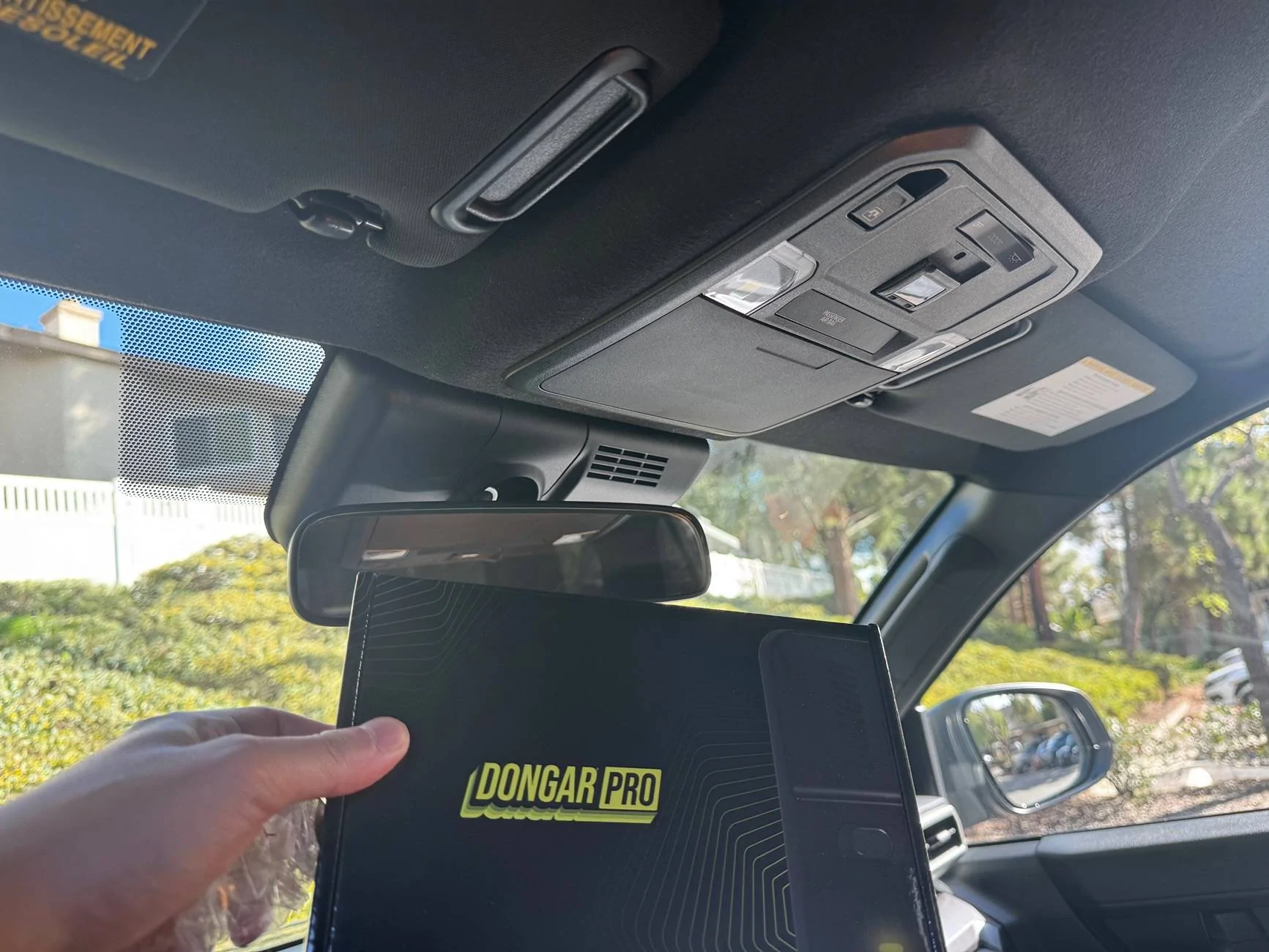

Anyone know the secret to removing this pod in the ceiling so I can install a dash cam? I’ve checked how it’s supposed to be removed on the 2024 Tacoma, quite literally just pulling with two hands from the front and it flat out doesn’t work here.
I’ve been pulling on this with various tools, tape, and even a screwdriver and it hasn’t budged.
Going to lose my mind over this since I need to pull it down to install this dash cam.

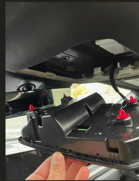

Just gotta pull hard on the map light console!. This is from a dashcam DIY from a 2024 Tacoma owner:

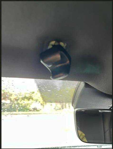

The most scary part of the process for the new truck is tearing out the top Map Light Console. The first time you take it off will take a lot of force and it seems like something might break, but it won't there are 4 red snap clips holding it in. pull the edge that's closest to the windshield off first, then the back. You also need to pull the visor clip out. You only have to turn it counterclockwise back to 10 o-clock then can pull it out.

Yeah I read that thread before attempting this. I’m not sure if the 4Runner just has a different setup but I was yanking on it hard enough to actually start disassembling the ceiling pod trim but it didn’t remove it. Tried again with me and my wife both pulling as hard as we could and no go.
