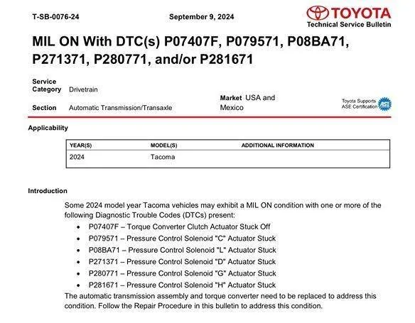

Here's the official TSB for diagnosis & fix of the 2024 Tacoma transmission failures :
2025 Toyota 4runner Stay AWAY! Transmission issue in Tacoma TSB 2024 tacoma transmission failure issue
So at least Toyota has officially acknowledged the issue and has a fix for it in place. Good timing ahead of 4Runner release so as to make sure the 2025 4Runner doesn't have the same issue.
Does it say anywhere what the estimated time to fix is? Like, it's it a 30 min job or 3 hours.
