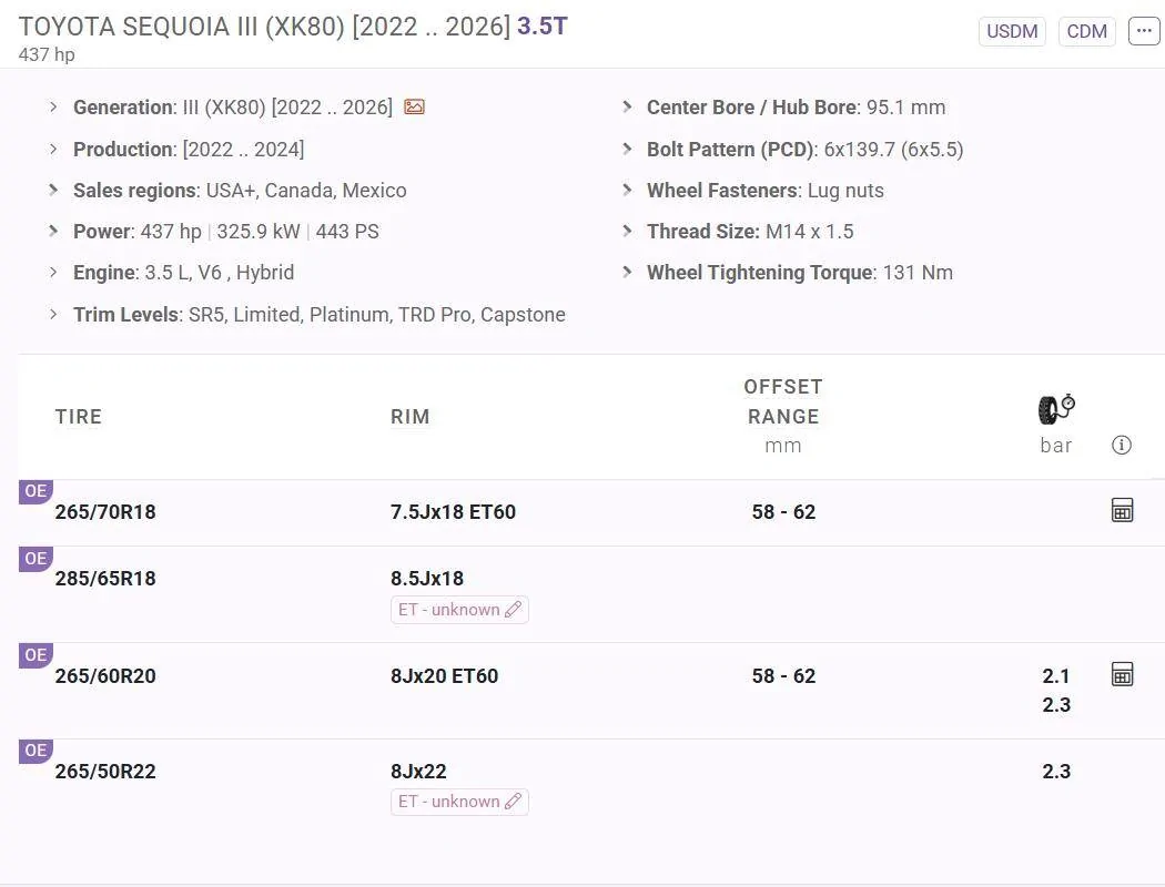

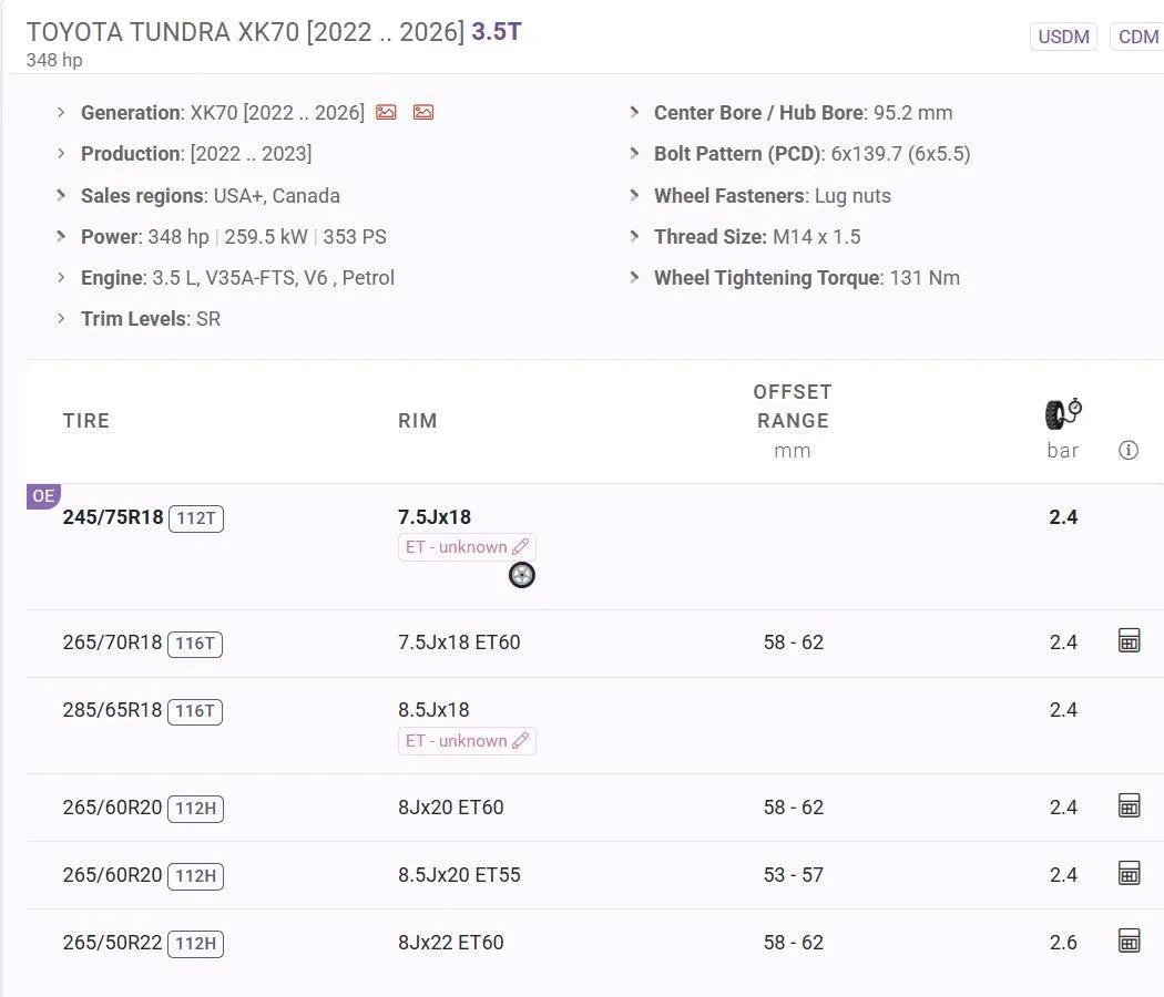

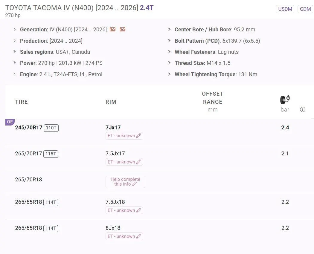

here you go ...

actually all the bof toyota's are the same now
tundra, taco, 4runner, sequoia
6x139.7 (5.5), 95.1 hub, M14x1.5 (not sure if that is correct) and around 58-62 offset and 131 nm torque
Yes, correct.
I meant 17" and 16" previous gen BOF Toyotas have the bigger 106.1mm hub bore.
So technically New wheels will not fit old gens like previously.
Example : I have 2018' TrdOF taco wheels on my 99' 4runner.
