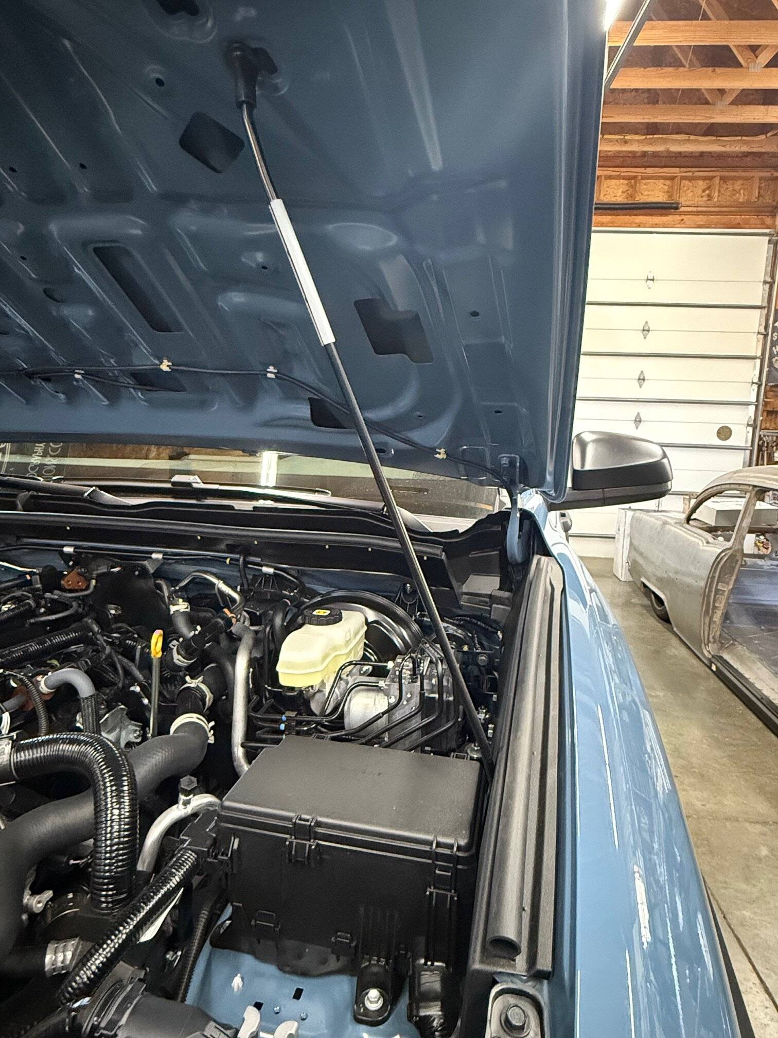

It's the little things that make your life easier, and this is one of them. If you're ever under you hood or like your oil changer, these days make is it much nicer, and safer. The stock prop rod is so cheap. Of all the ways to save a dollar.

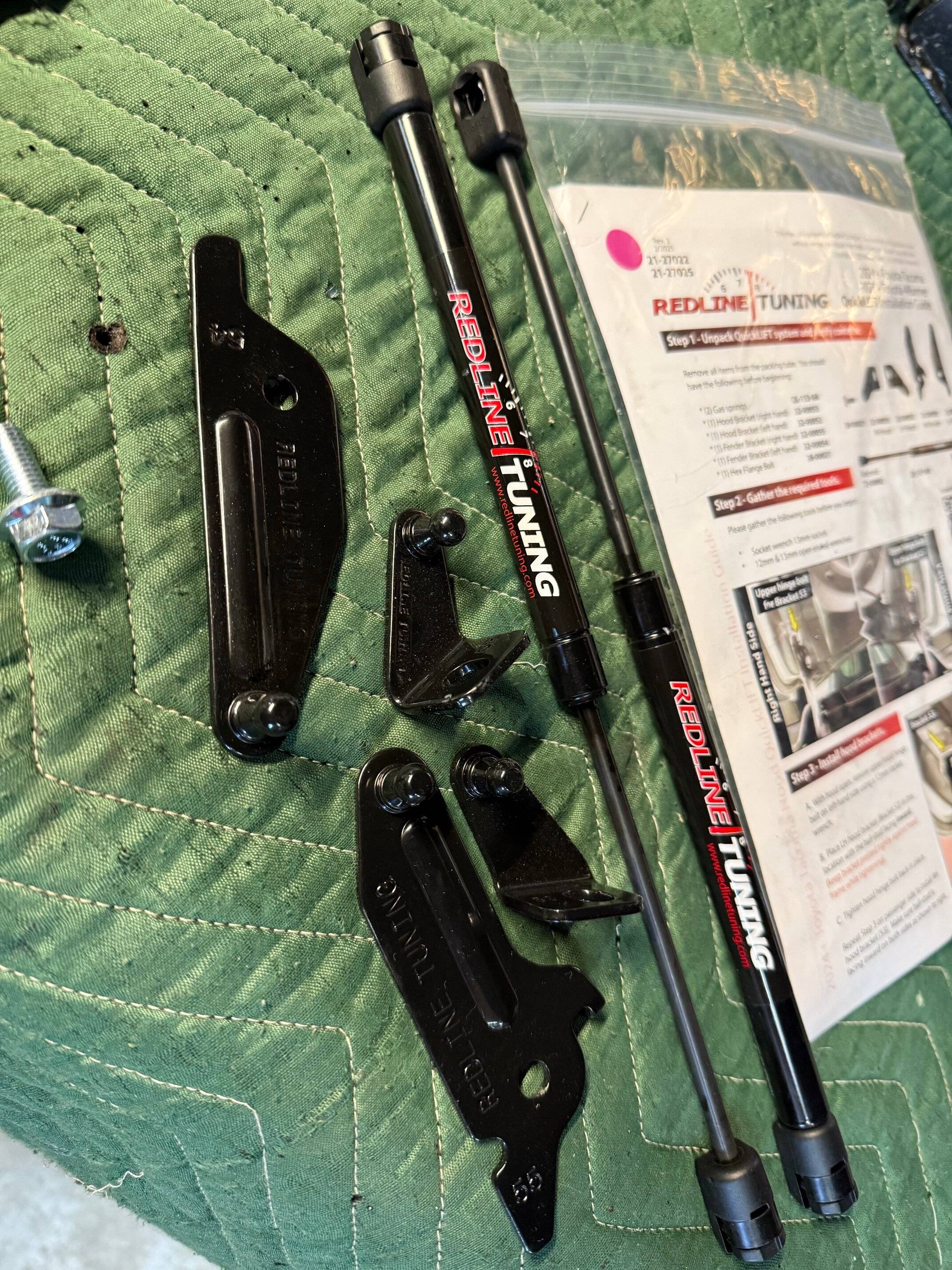

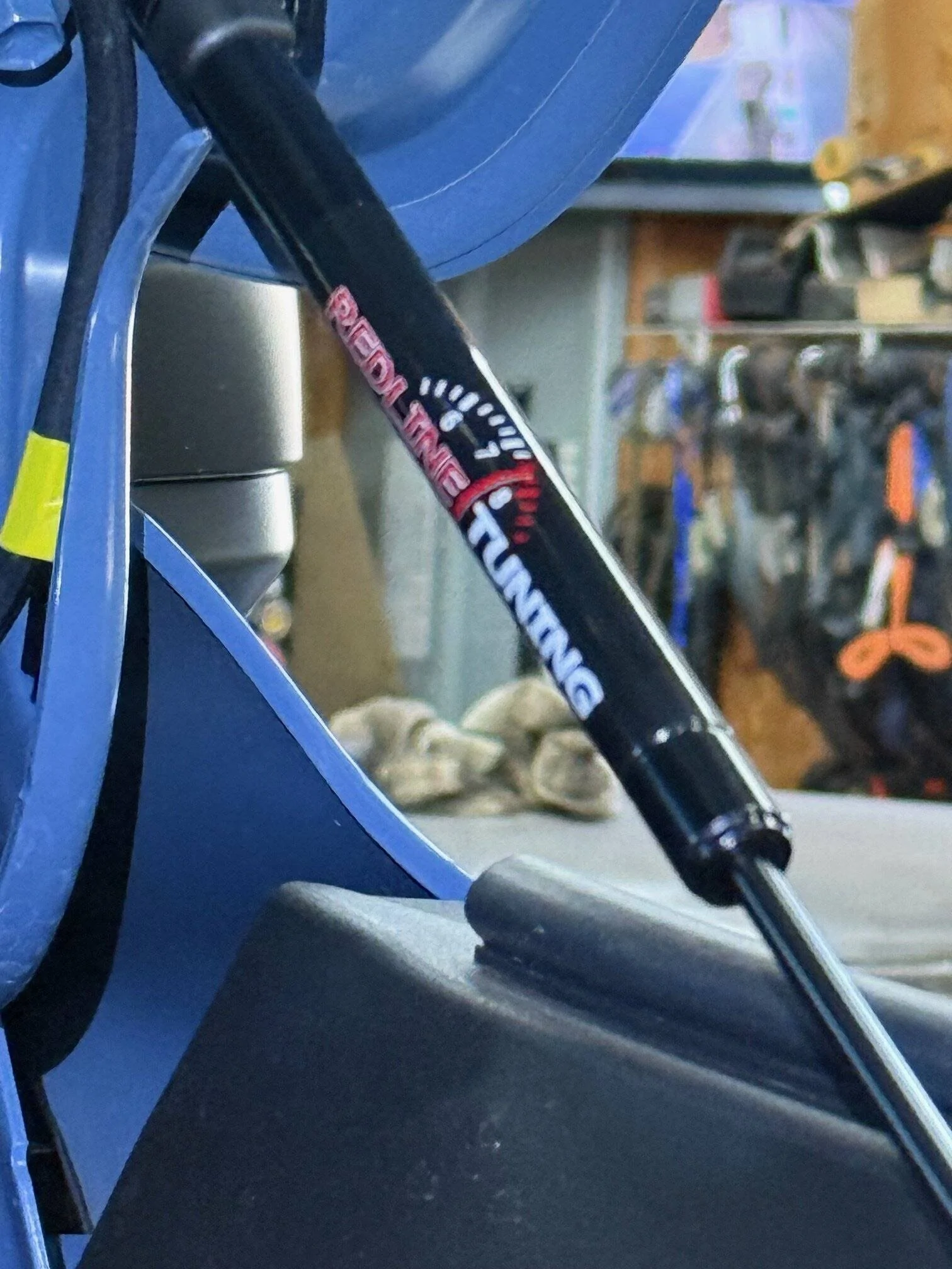

Anyways glad Redline has a great hood struts kit, super simple to install. Remove the hood bolt, install it back with the upper bracketed attached. On the body side there is already a threaded hole on the passenger side. On the driver side you use one of 4th abs module bolts to secure the lower bracket, pop on the struts and you're done. 15 minutes install.
2025 Toyota 4runner Installed Redline Hood Struts QuikLIFT kit IMG_7374
2025 Toyota 4runner Installed Redline Hood Struts QuikLIFT kit IMG_7369
2025 Toyota 4runner Installed Redline Hood Struts QuikLIFT kit IMG_7366

Will you post pics of the installed attachment points?
